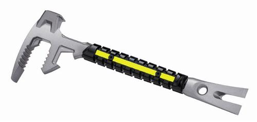

   / What is this tool? #13
This is what I use now for demolition.

   / What is this tool? #14
Place the solid jaw on the edge of a nailhead, on the wood right on the edge of the nail.
Lift the sliding handle, slam it down a time or 2. Keep the jaw on the edge of the nail head.
The sliding hammer will put the jaw intot he wood a tad, and slipped under the nail head.
Close the jaws and pull the nail out using the little tab as the fulcrum.
This leaves a small dent in your wood. Much less damage than any other tool.
Keep your hand away from the sliding part of the handle, you _will_ get blood blisters or worse when using or carrying the tool and the handle slide closed. Happens to everyone until we learn....
--->Paul
   / What is this tool? #15
