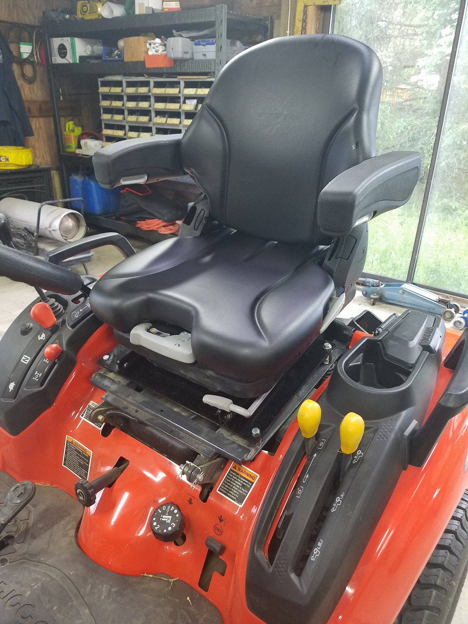

Well I fixed the seat problem. I bought a Grammer MSG65. I have yet to mow with it, but it is much more comfortable.
How comfortable is the seat itself? I know the air suspension helps I'm just trying to figure out if the actual Grammar seat gives enough support compared to the OEM. Ideally I'm looking for a comfy cloth covered seat, I hate the rubberized ones.
BTW my OEM M59 Kubota seat is a 1/10 for comfort. I've ridden antique tractors with cast iron seats that are more comfortable. I feel like I'm constantly sliding off while riding the jack hammer...

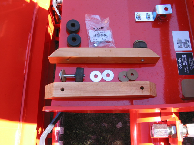

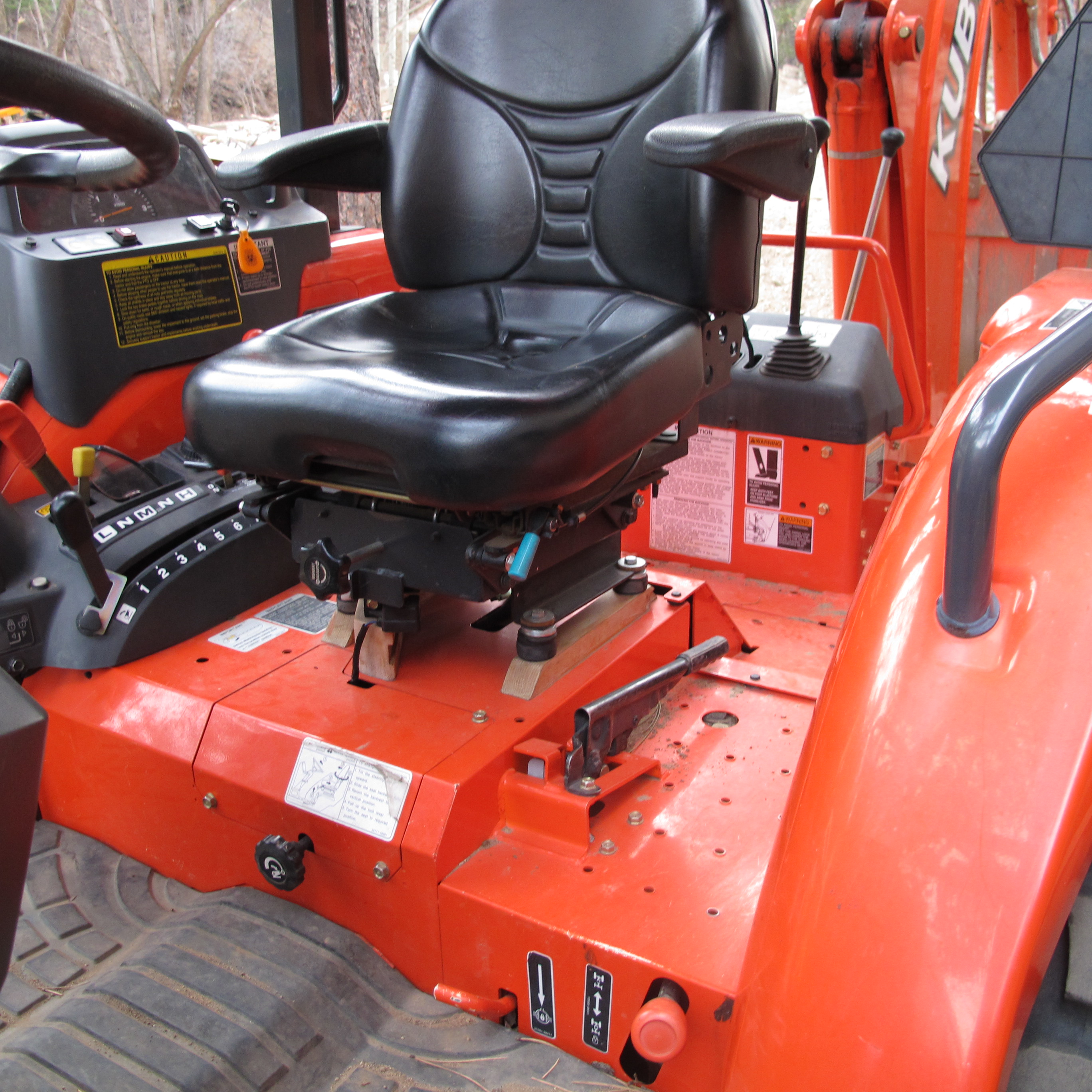

I'm thinking of putting an air ride seat on my M59 as well. But the stock seat can be made much more comfortable with a $10 trip to the hardware store.
Here's what I did to mine. Raised it up and added some rubber spacers.
rScotty
