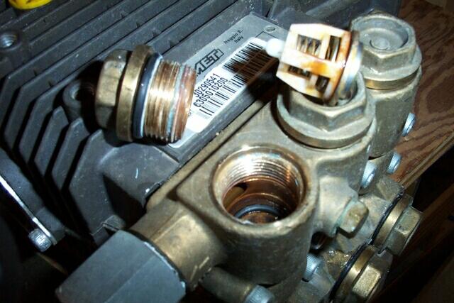

My Pressure Washer is capable of 3000 psi at 3gpm. After four years of homeowner use, it has begun to behave poorly. When I start the machine, the pump only produces about 500 psi. The engine runs strong but is clearly not under load. After about 5 minutes of operation, the pump will suddenly kick up to full power (about 2800 psi). Here is a picture of the Comet pump with one cap removed.

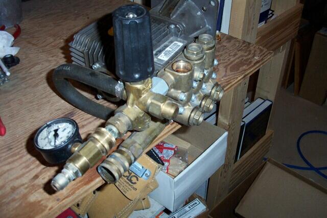

There are six valves of some sort on the unit. I removed and inspected each one. They all operate and seem free of minerals. See pic.

Sounds like a sticking unloader valve (pressure relief valve). I had the exact opposite problem with mine. It would not release pressure when not pumping water. I took it apart, cleaned it up and it's worked fine ever since.

Jerry I would agree with Greg and first suspect the pressure relief. Yours looks similar to the one installed on my machine and appears to be adjustable (large black knob in picture). Have you tried completely backing it off while running, turning it counterclockwise and then readjusting it turning it clockwise to see if that might clear any sediment and get it up to operating pressure.
The op book that came with my pressure washer also lists a worn seal or packing, worn or obstructed valves, or a worn unloader piston as possible causes. I hope some of this info helps you.

I ran the unloader valve all the way in and then back out. I'm pretty sure the unloader is the problem as it works much better now. I used the pwasher today and it only acted-up once and I could see the spring on the unloader valve pop up when it kicked back on. Next step will be to remove the valve and give a good cleaning and polish of the surfaces. Thanks again.

Also, in my first photo, you can see a brass cap to the right of the unloader valve. This cap has vent holes in it. Water drips out of this vent even with the engine turned off and no pressure in the system (other than the 50psi from the garden hose input)
