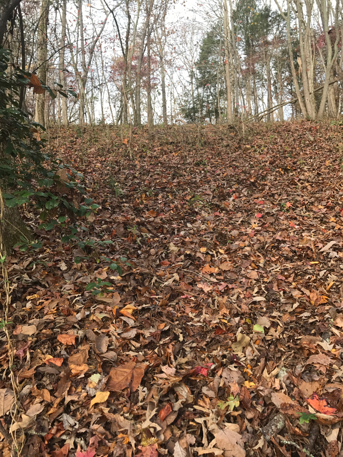

The area to be cleared isn't very wide. I'd planned on making a couple passes down the hill keeping the tracks up and down the hill.
   / What kind of a hill can a mini excavator handle. #13
You should be good then. Blade always on the downhills side of course...

Here's a picture looking up at the hill. It gets worse below where I was standing? But I doubt much work would happen below that. IMG_0681.JPG

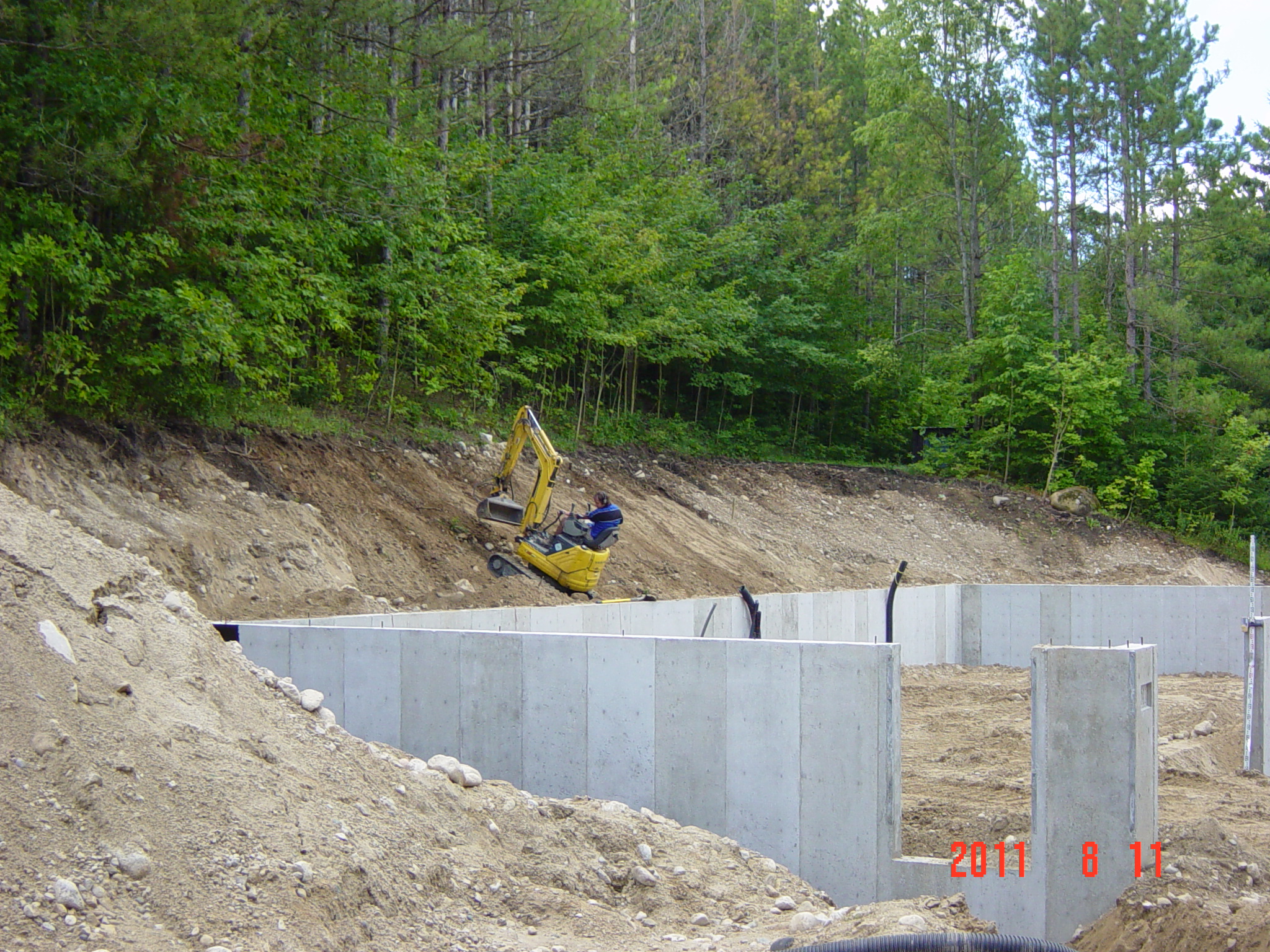

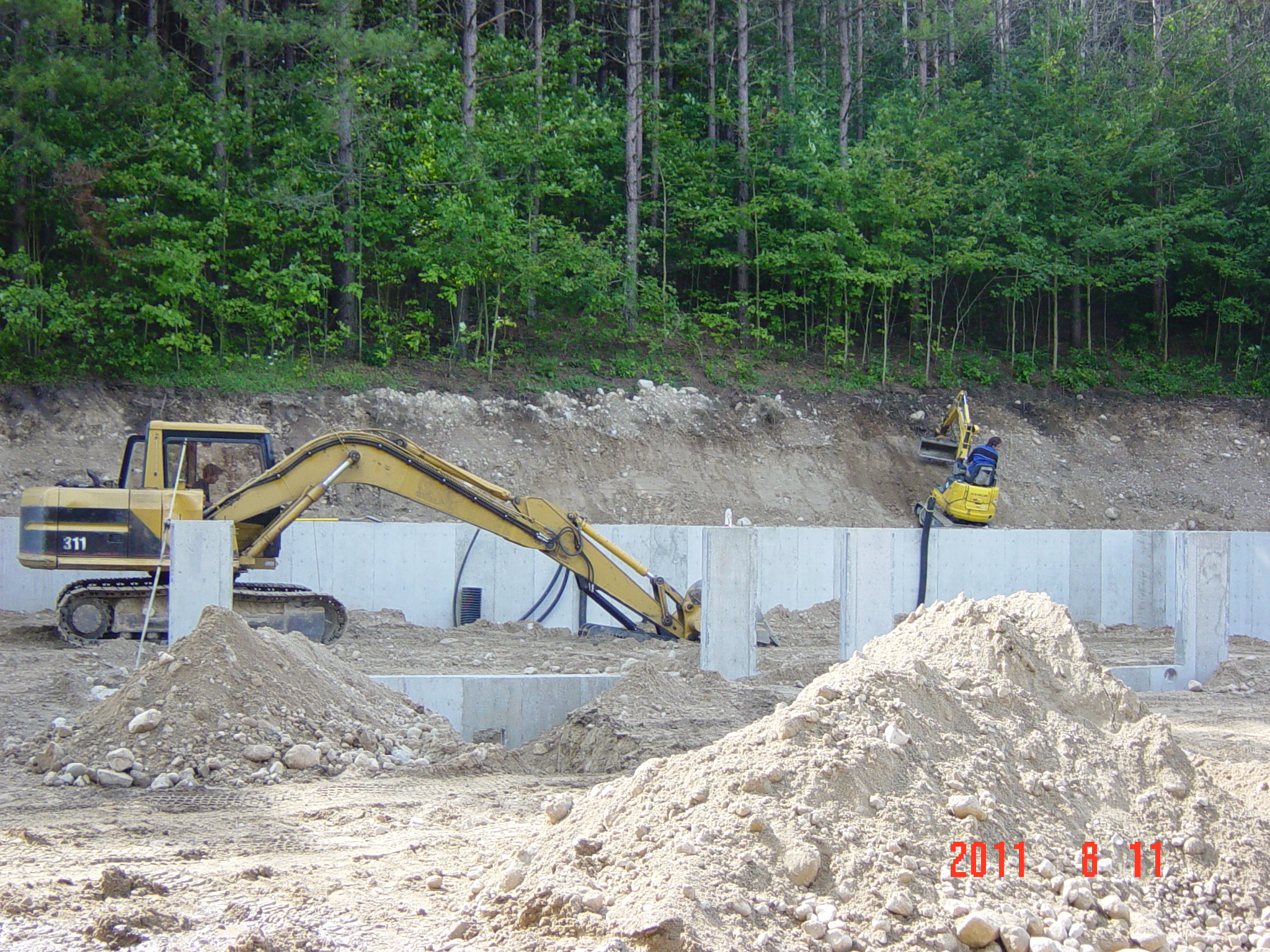

When I had my drive shed built. A picture is worth a thousand words.
Quite impressed with the little NH mini ex
