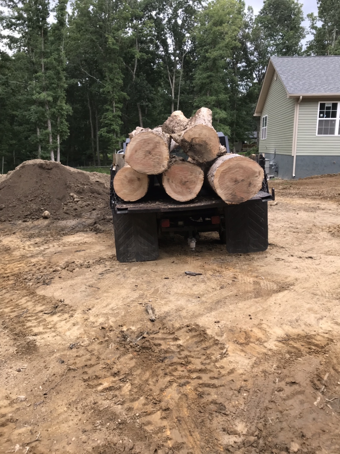

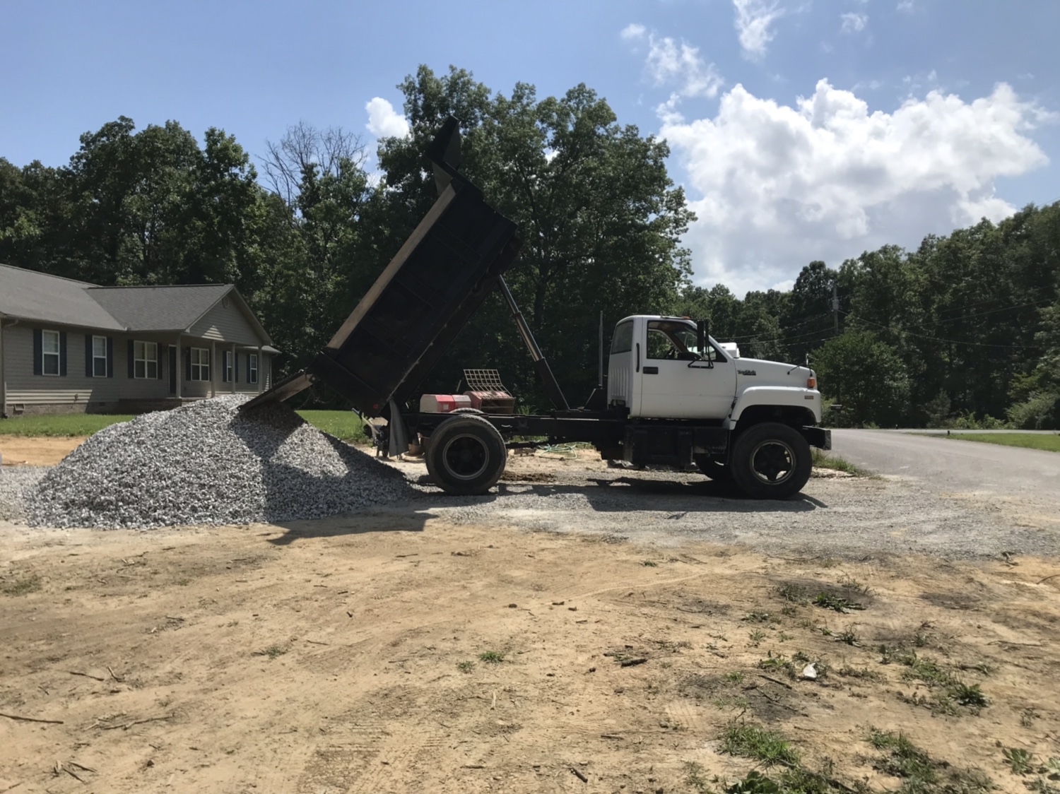

I have a 1 ton with a dump bed. And I’ll never own another regular bed truck. It’s the difference between owning a tractor and having a tractor with a loader. A flat bed wouldn’t be too bad. Mine is a 3500 DRW truck but a 450 class truck would be a lot better. I haven’t found a 1.5 ton dump that I like so I have a 6500 dump too. IMG_6987.JPGIMG_7062.JPGIMG_7070.JPG
