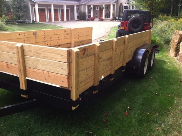

Here is what I did. Used PT 2x4 for posts and deck boards. Bolted together. I have an 18' car hauler so it is actually in 5 pieces so I can actually lift them by myself and I didn't have to splice. I used hasps and hitch pins to secure together at corners.

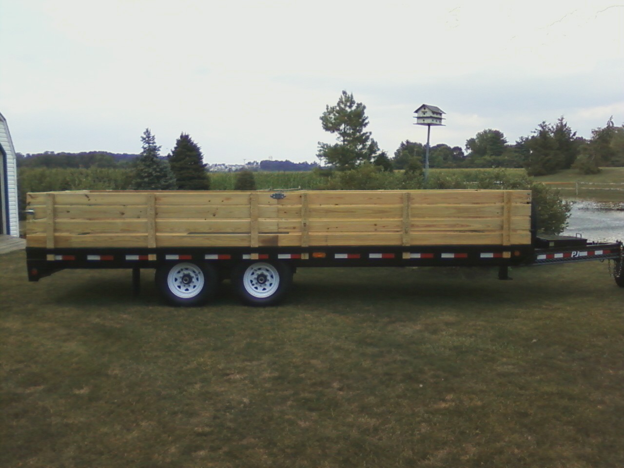

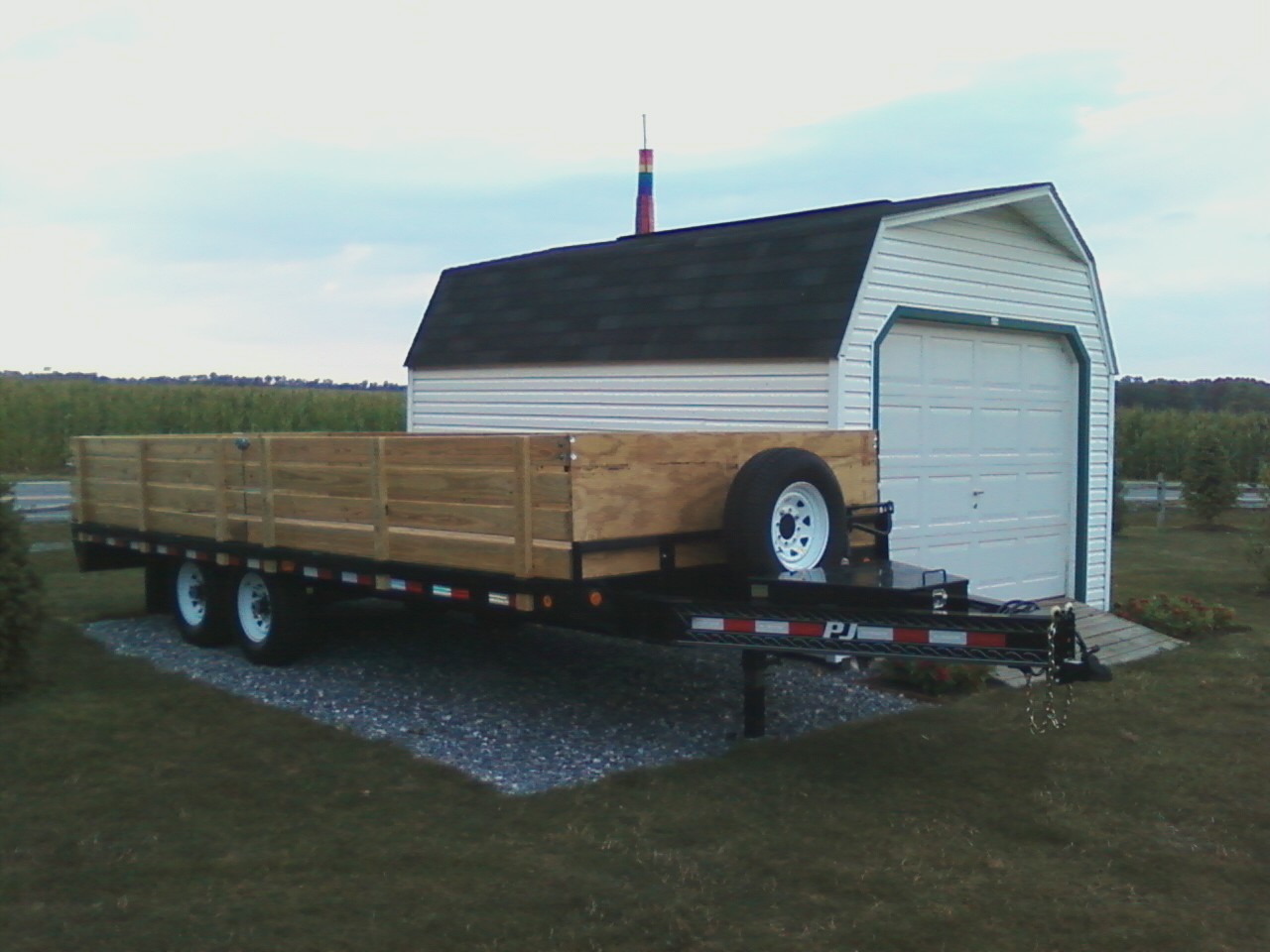

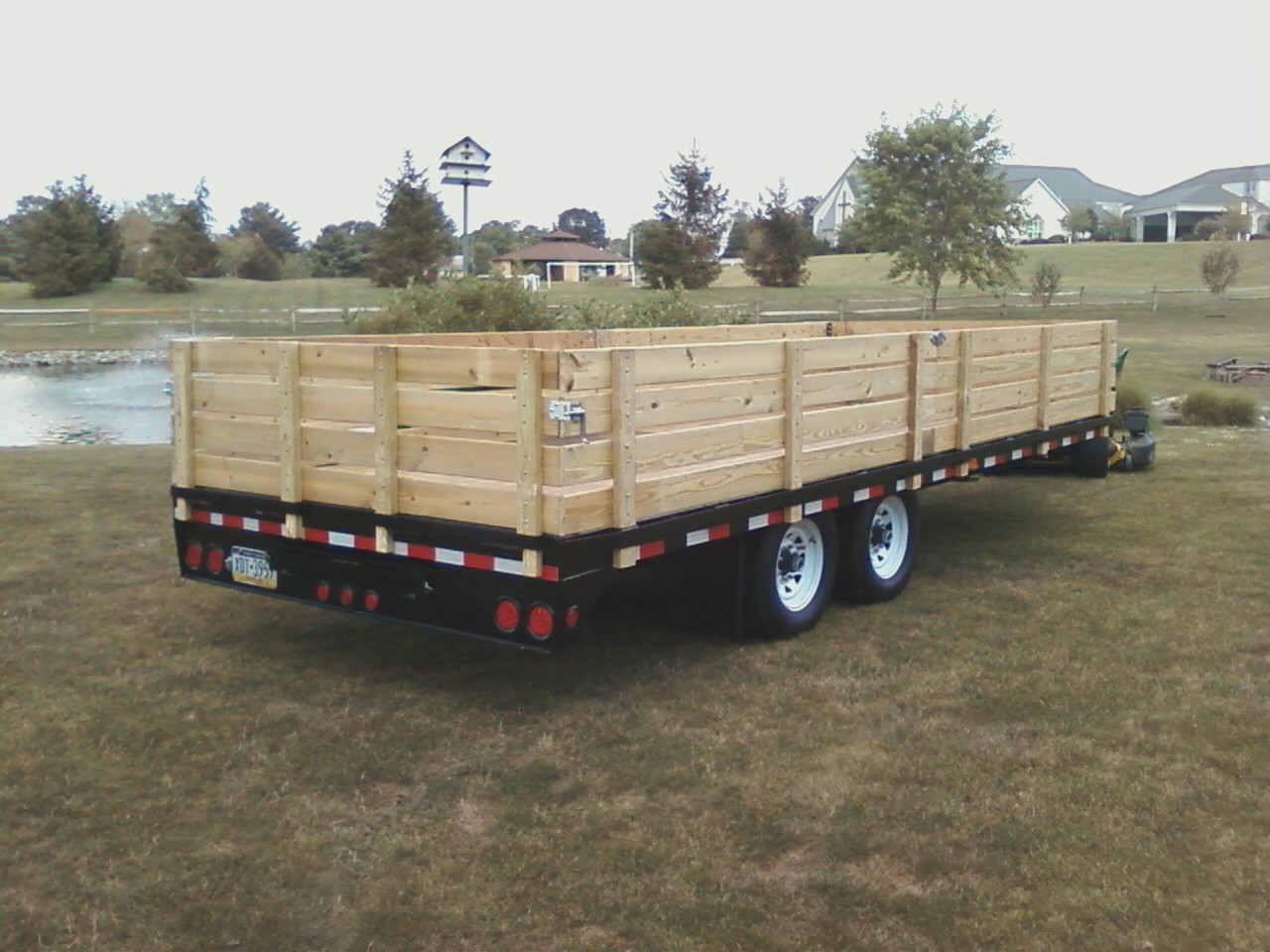

I used pt 1'' x6"

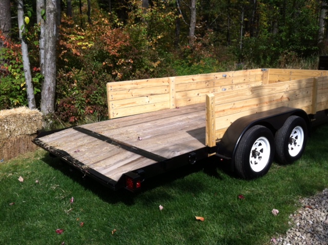

   / What kind of boards to use to build sidewalls on trailer? #18
Nice - what did you mount your trailer tire with?
I ordered it with the factory spare mount. It is welded to the jack. You can kind of see it in this picture...
