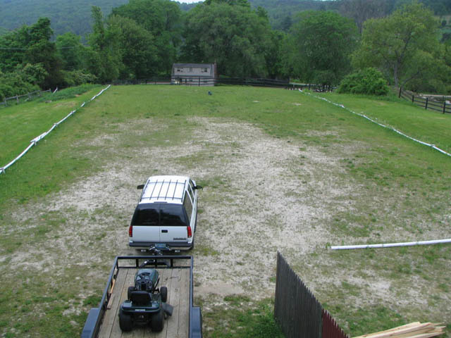

I wanted to thank everybody for their input on the harrow and the ring, which is basically done. I say basically because the Misses thinks she wants it just a little wider. It started out about 85' X 185'. Right now it is about 110' X 200'. She would like to have it made about 20' wider. Checking the $$$ for that now and seeing if I can find a money tree somewhere in the nearby woods.
Regarding the harrow, I have narrowed it down to either a TSC drag harrow or some chain link fence and pipe and make my own. I'll check out TSC this weekend.
Thought I would share with you before and after pictures. I climbed up on the roof of the barn and snapped these off.
Here is the before.

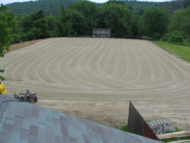

Here is the after. The surface is a course sand about 3 1/2" deep.
