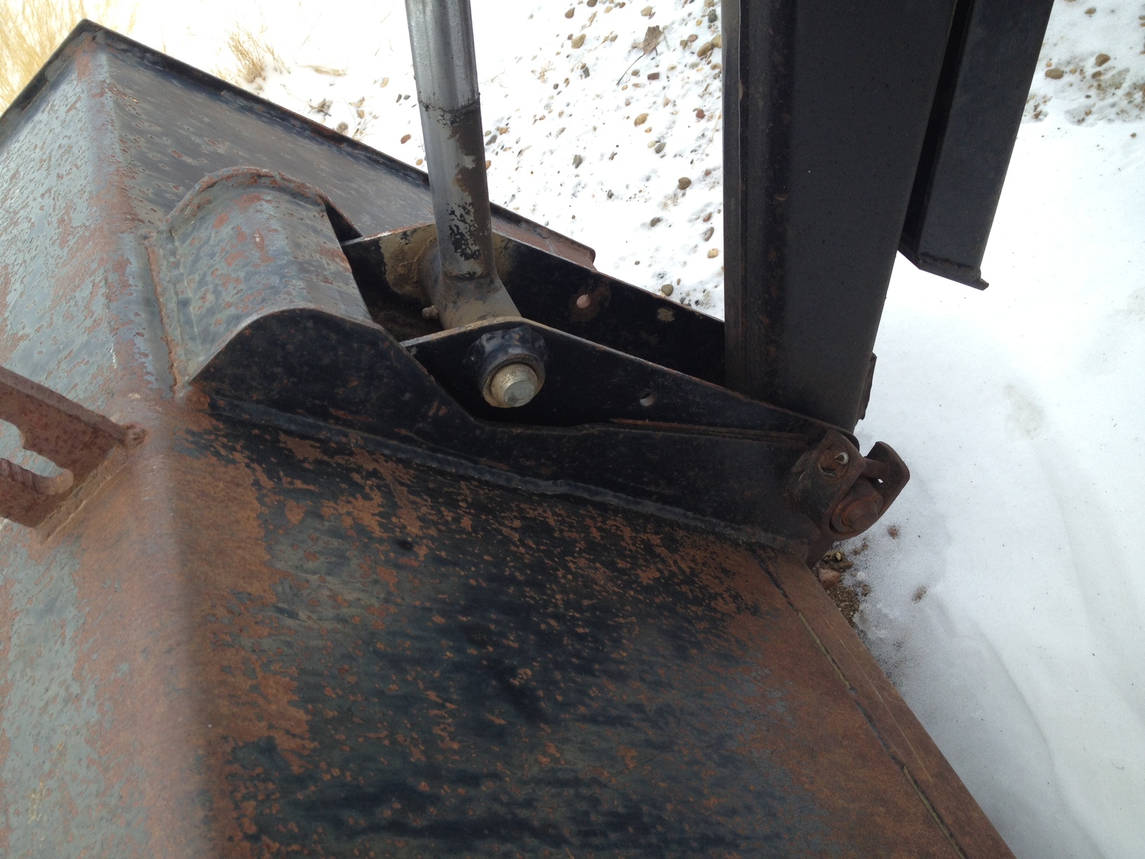

Hi all,
I have a Kubota L4200 with a Bush Hog 2345QT loader. I'm wanting to buy a pallet fork attachment. I thought about the forks that attach to the bucket, but I'll be lifting some loads at the max for the loader (pallet of wood pellets). So, I have some questions for you:
1) What is this attachment called, where the bucket connects to the loader arms?
2) I've never removed the bucket since I got the tractor. But, it seems I could just remove that vertical pin and cotter pin (see the bottom of picture A) from the horseshoe shaped metal piece and slip the arms out of the bucket. Am I correct in this? Seems like its some sort of quick detach.
3) What do you recommend for a vendor on the pallet fork attachment?
Thanks all!

I believe that is proprietary to the Bush Hog loaders. I've only ever saw one other like it and it too was on a Bush Hog loader.

You could get 3pt forks. More lift capacity, standard interface.
Not much lift height & you need a top cylinder to dump from level though.

I suggest you purchase some pallet forks and a carrier from a forklift place and make your own carrier.
I purchased a 16 in carrier from a forklift place for about $75 and adapted some brackets to fit my Power-Trac. I had some spare forks.

To chime in, I would convert to SSQA also and be done with it. Little bit of money up front, and then the ease of changing out front implements and a world of selection to choose from. Also when I had those pins out, I would clean out the rust in the grease channels and lube them up. :) Most loader manuals call for greasing the pins every 10 hours of loader usage.:)

To chime in, I would convert to SSQA also and be done with it. Little bit of money up front, and then the ease of changing out front implements and a world of selection to choose from. James K0UA
I don't have any experience with the Bush Hog system, but the pictures indicate, at least to my eye, that it would be a major PITA to switch between implements. There's a reason for the popularity of the SSQA system -- it makes switching implements a piece of cake.

Another question for you. If I convert to the SSQA, can I just grind off the Bush Hog attachment points and weld some aftermarket SSQA to my existing bucket? Might be the best way to go, as you all have said. Thanks again in advance.

Yes -- here are two examples: Skid Steer Quick Attach Weld On Plate for Buckets,Pallet Forks,Bale Spears,etc. and Construction Attachments Weld-On Skid Steer, Skidsteer Universal Skid Steer Quick Attach Plate (with video instructions).
