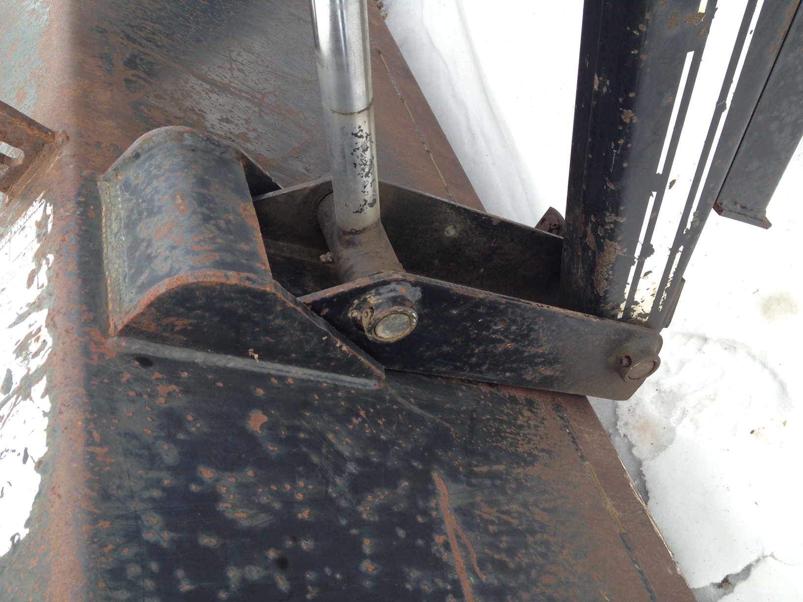

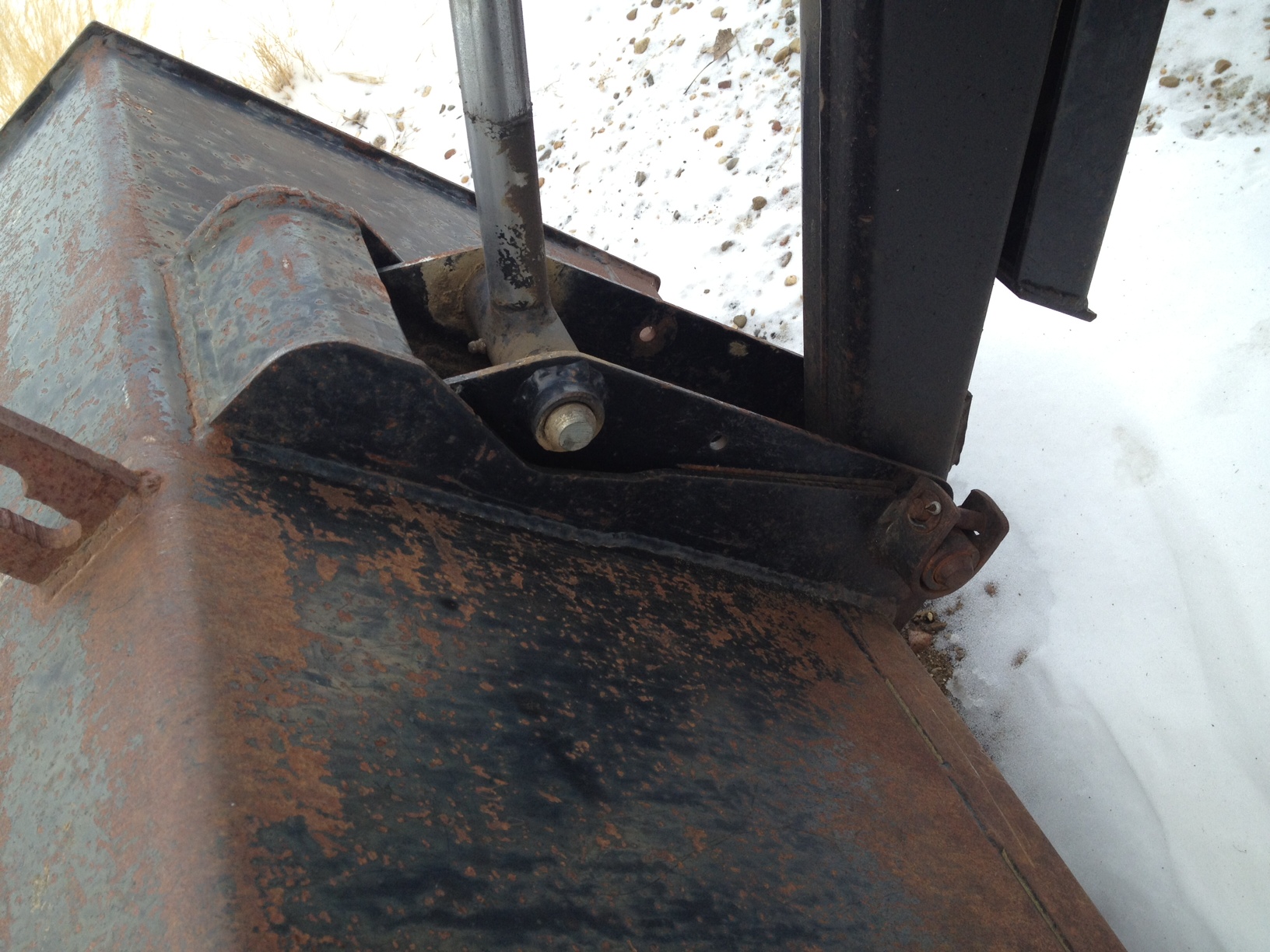

All great comments. Thanks all.
Another question for you. If I convert to the SSQA, can I just grind off the Bush Hog attachment points and weld some aftermarket SSQA to my existing bucket? Might be the best way to go, as you all have said. Thanks again in advance.
Yes you can get a SSQA plate for about $125 for your bucket.

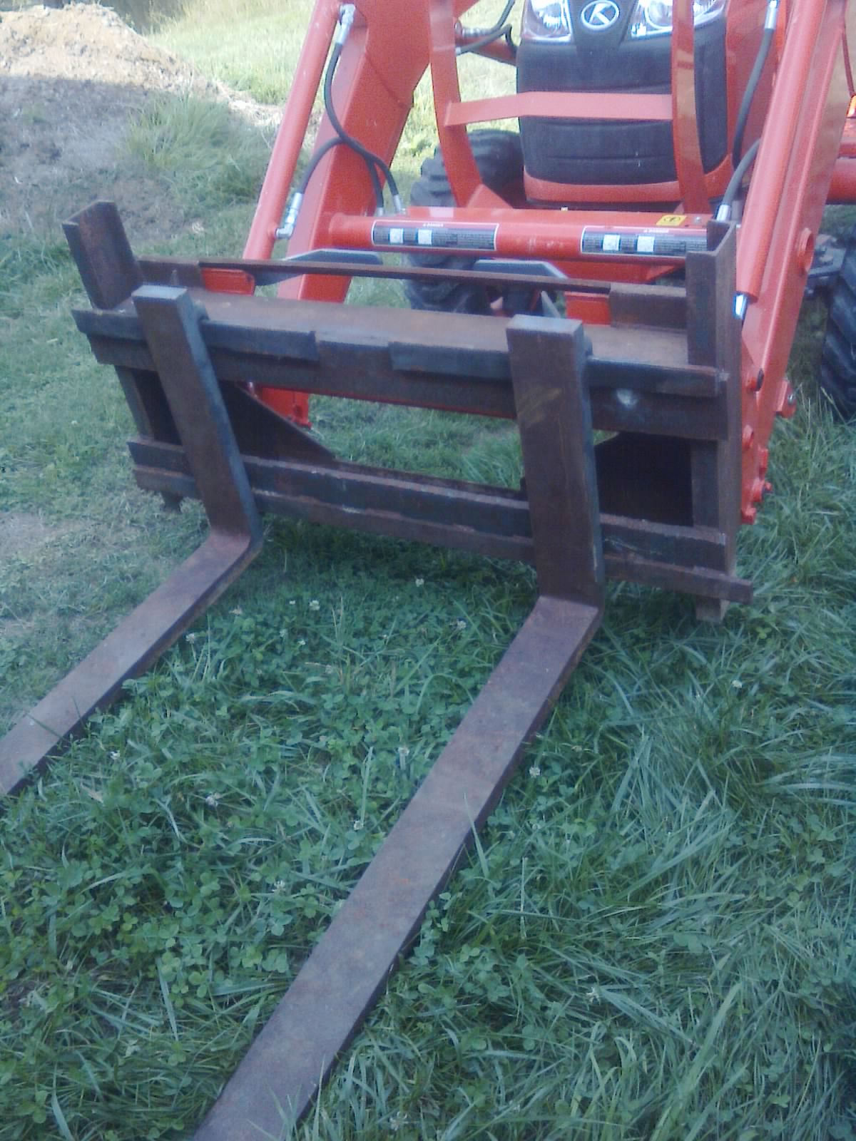

   / What kind of loader attachment is this? (on a Bush Hog 2345QT loader) #13
These forks were on cl and were home made with the purchase of a QA adapter and 42" forks.

Hi all,
I have a Kubota L4200 with a Bush Hog 2345QT loader. I'm wanting to buy a pallet fork attachment. I thought about the forks that attach to the bucket, but I'll be lifting some loads at the max for the loader (pallet of wood pellets). So, I have some questions for you:
1) What is this attachment called, where the bucket connects to the loader arms?
2) I've never removed the bucket since I got the tractor. But, it seems I could just remove that vertical pin and cotter pin (see the bottom of picture A) from the horseshoe shaped metal piece and slip the arms out of the bucket. Am I correct in this? Seems like its some sort of quick detach.
3) What do you recommend for a vendor on the pallet fork attachment?
Thanks all!
