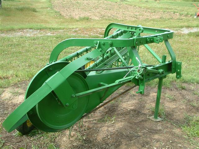

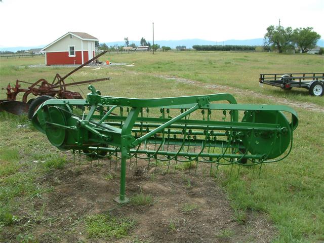

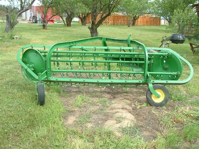

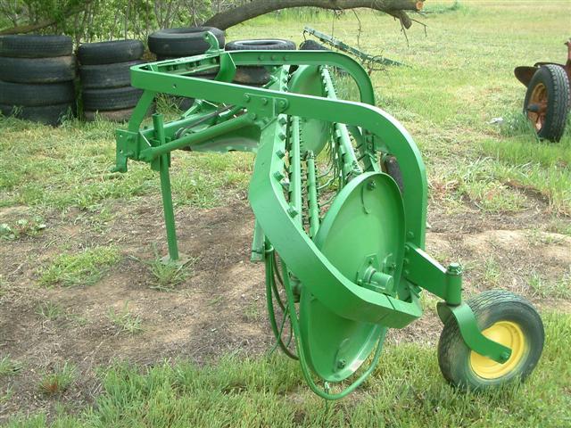

Hello, "roller bar " is obviously a us-of-a term .Can some one please explain what they look like? I am from new zealand. Around here (waikato) we use single, twin or 4 rotor rakes and very few v rakes as they are more a hay tool then dual purpose hay and silage.Also v rakes are said to do a poor job on hills and uneven ground. This part is all hills, and some is quite rough.
Here are a few photos of my restored John Deere 350 side delivery rake (aka rolabar rake). It's a PTO-driven rake that's carried on the 3pt hitch. More often rakes like this are towed and the raking mechanism is ground-driven by the two support wheels.
This rake, like most side delivery rakes, has 5 bars that carry the raking tines.

Hello, flusher, rtimgray and aczlan. Thank you for explaining what a rollabar is. I haven't seen one before. Excuse the slow reply , I have been away for several days.
