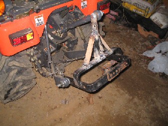

well this is what I did with it last night
   / What kind of Rods to weld with a 110 welder
#17

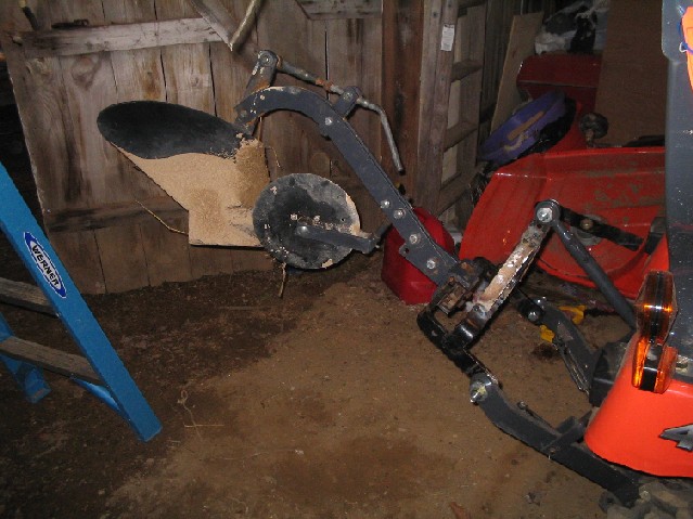

and
#18
cut it all back apart and going to reweld tonight with some 7018 rods. I hope (if they work) the 1/16th and 5/64 6011 and 6013 rods held it together but looked like crap. So I am going to retry it with some 3/32 7018 tonight

I am going out on a limb here, and nothing personal intended I assure you. I am guessing it is the experience of the welder and not the rod. The result of what I get with a given rod and the result of an accomplished welder with the same rod is vastly different. /forums/images/graemlins/frown.gif I am slowly getting better though. /forums/images/graemlins/smile.gif Tried to find a local voc ed welding class but haven't found one yet.
I am just guessing here and a real welder can correct me if I am wrong. But I think on that heavy material, the larger the rod the better the result.

yep the larger rod did make a stronger weld but there just wasn't enough current there to keep it burning, So I used the 6013 5/64 rod to make the weld and the 1/16 6011 rod to fill in. Tonight I am going to try a 6013 rod that is in between the size I had and the 1/16th 6011 rod ( gunna try 3/32 6013) and also want to try a 3/32 7018 rod because from what I have read the 7018 is stronger and will penetrate a bit more.
I am sure the majority of the issues I have had are operator error, but that is all in the fun of learning.
I do know for sure that those 1/16 6011 rods burn up really quick and didn't penetrate hardly at all.
Well I guess I will see how it goes tonight.
Let me ask this though, if anyone can tell me.
If I burn a 1/16th 6011 rod at 90 amp, it burns up really quick and I got no penetration, as a general rule if I lowered the amp and can still get the rod to burn good will the penetration be better at low amps or higher amperage??
I would think slower burning (lower amps) would give better penetration but that could just be too logical to be true.
Can anyone tell me?
