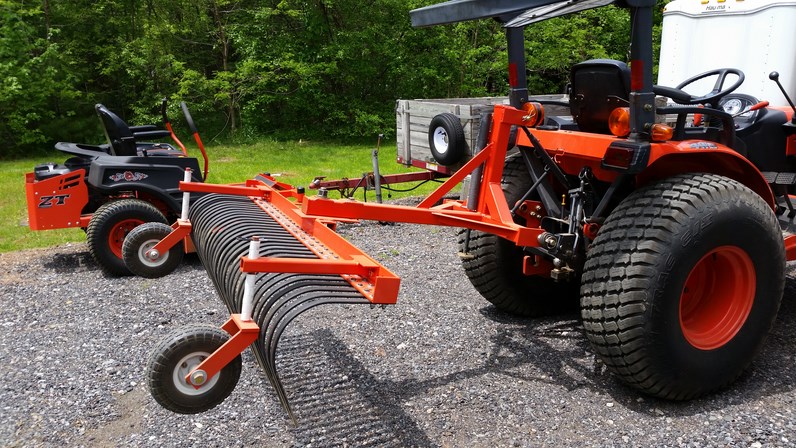

Like most have said you definitely want a 220V machine. My Lincoln MIG 180 has been great. 90% of the time I'm welding with gas. Had to use flux core a few times outside. It was initially purchased for a Jeep build I did with my son. It's also build some nice add ons for the tractor!
York Rake...

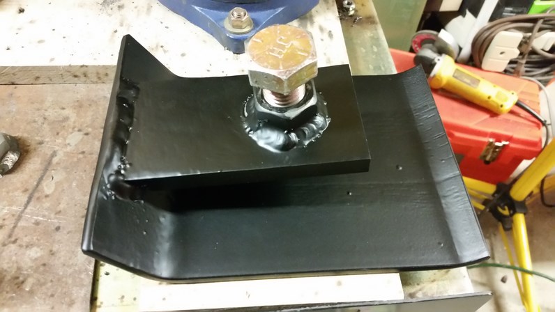

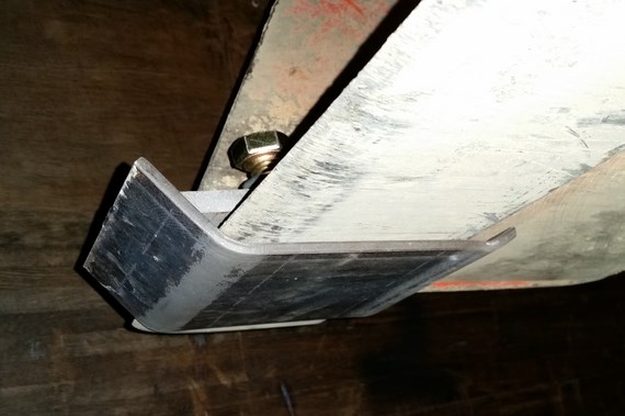

Bucket Skids for snow removal on gravel

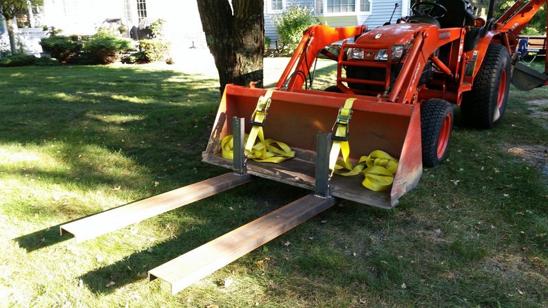

Pallet Forks...

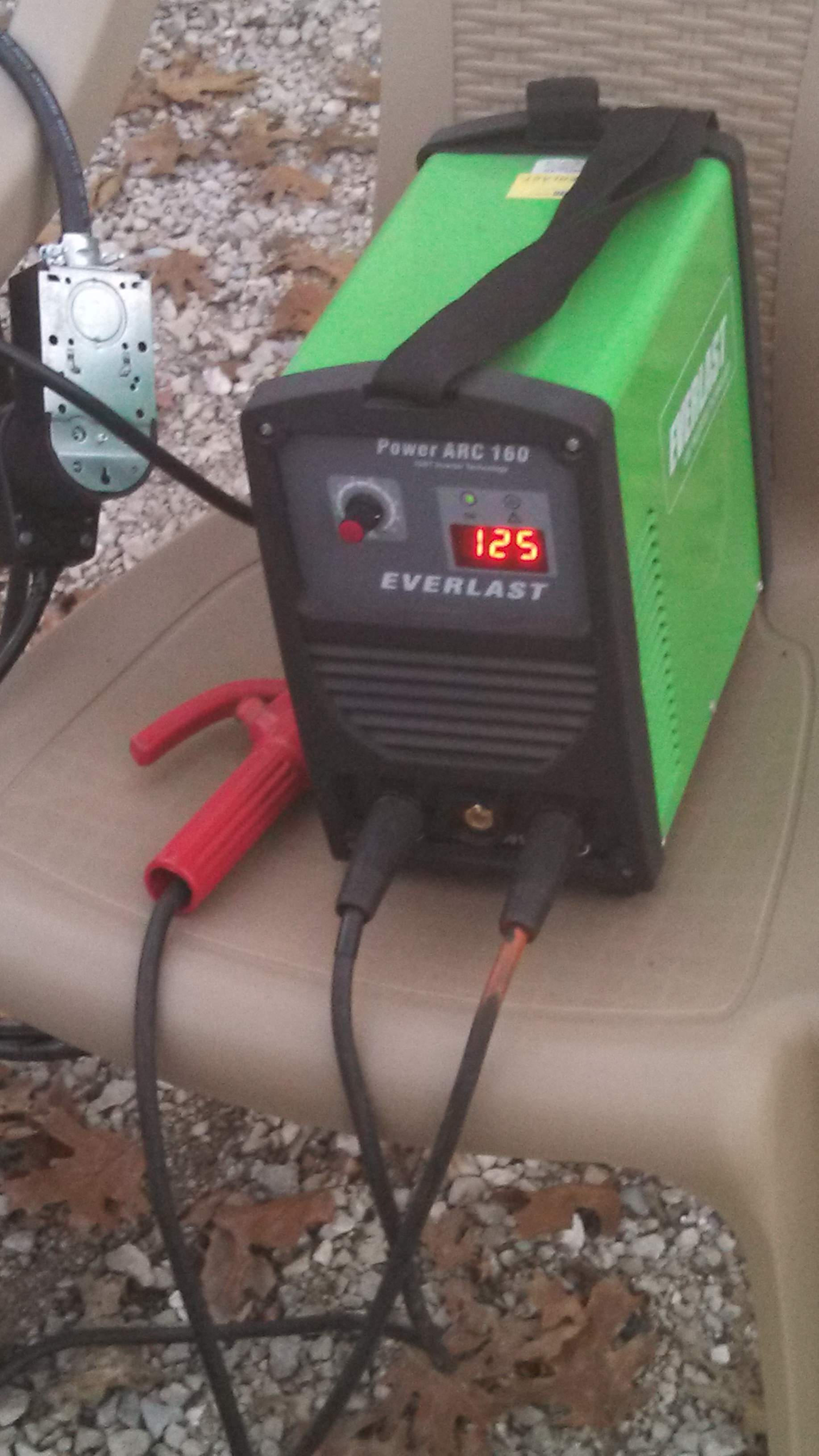

I am very pleased with my little Everlast PA160. 160 amp DC welder. I gave $265 for it several years ago. I don't think they make this exact model any more, but I think they still make the PA200 a slightly larger model. Sure this is a stick welder, and the learning curve for stick is steeper than a MIG welder. So may people recommend a new person getting a MIG welder. And that is fine, but they are more complex. And setting up a stick welder for a different rod and different task takes a couple of seconds instead of minutes. But each to his own. I also use my PA 160 to TIG weld, yes it is scratch start, but it does the job, and it was very economical to get started in TIG welding for small parts and non ferrous metals. (except aluminum) So overall get whatever pleases you, but I have sure enjoyed my little welder. And it can do some pretty fair sized jobs. For a welder that weighs 20 lbs and you throw over your shoulder on a strap to transport it. It will run 1/8 inch 7018 at 125 amps all day and not break a sweat.
