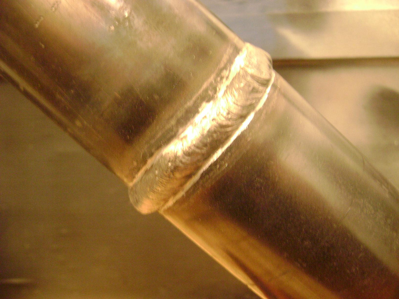

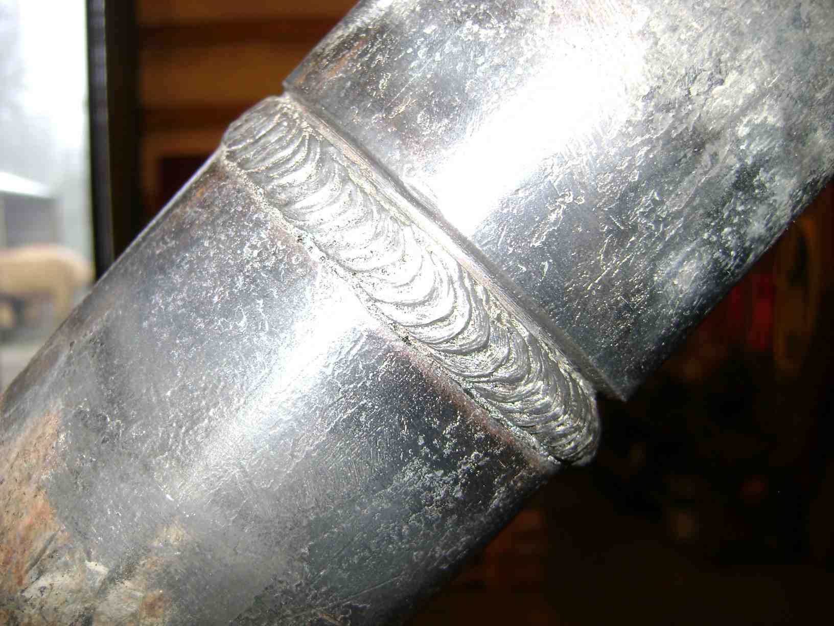

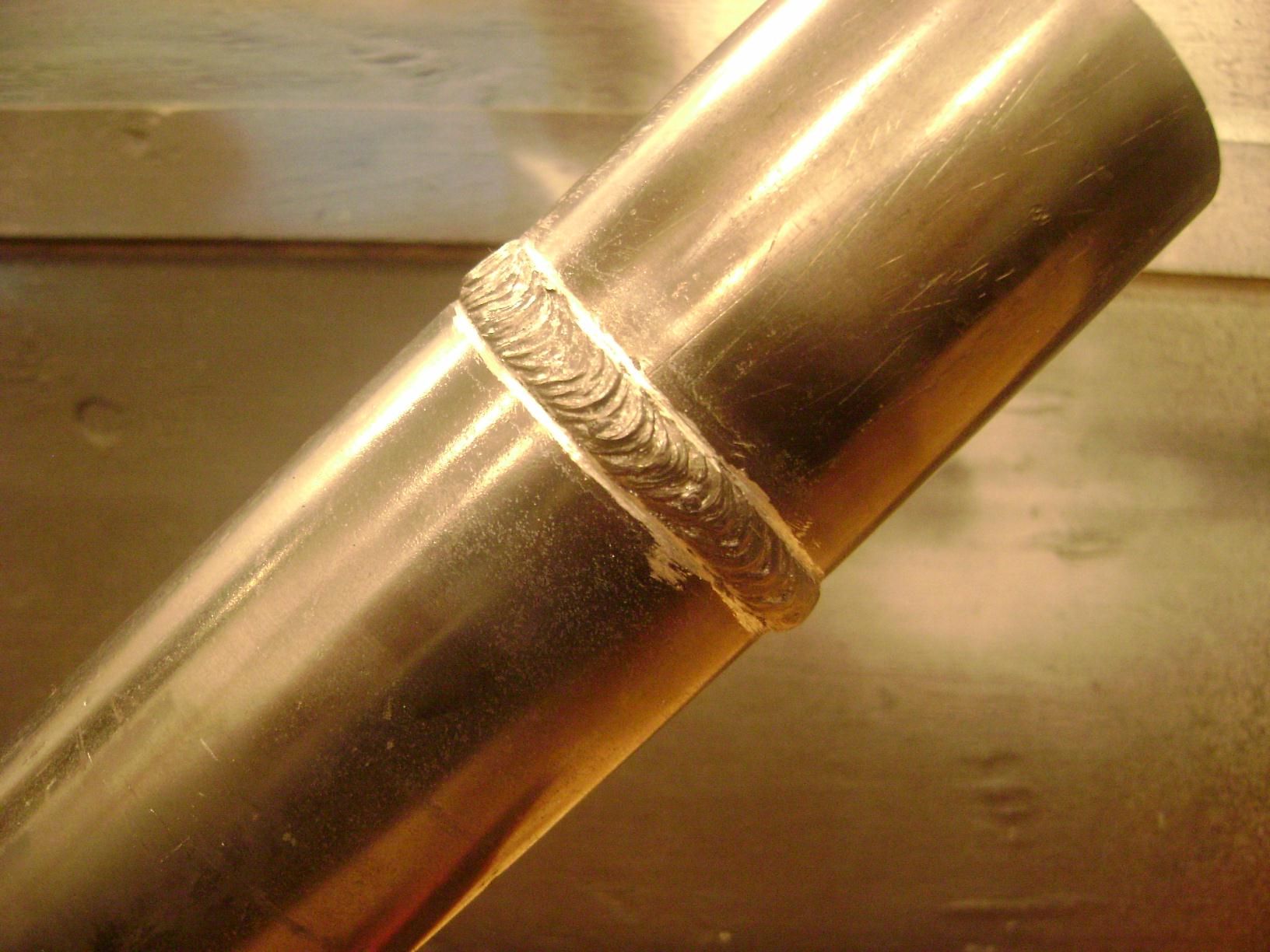

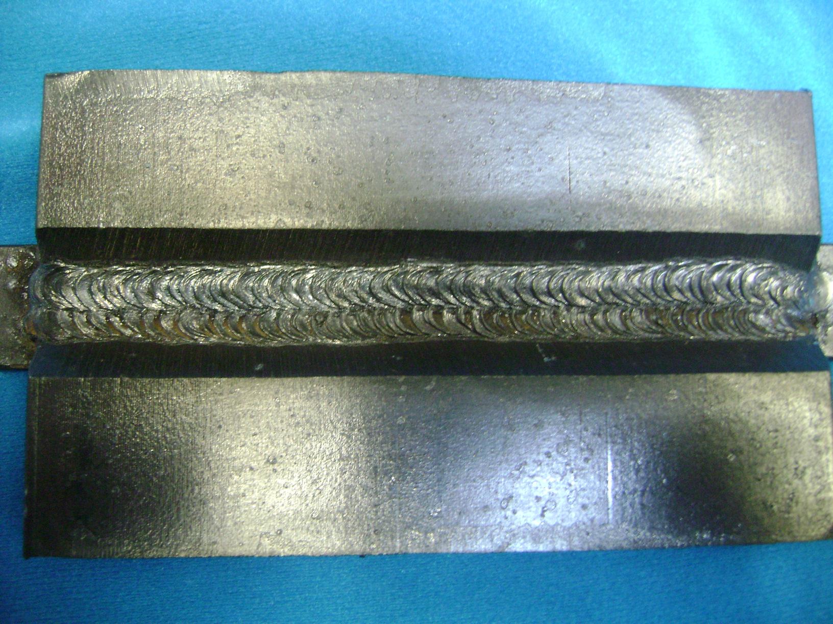

No, it should handle 6010 fine just as all have verified their experience. Shield ARC certainly has published a few pictures. I can't remember, do you have a 3 port or 2 port machine? Either one is rated for 6010. It DEFINITELY would be the first complaint out of all of them about not running 6010. If anyone has ever tried to put the arc out with a 6010 in a PA 200, it just keeps burning typically. Never, ever had that complaint...Had a work clamp or two issue...but not anything else.
And the unit has built in arc force control...If something is wrong with your welder, you need to see about it, and we'll make sure it works for you but don't tell someone that it doesn't have that capability. Out of what I guess must be several thousand sold, all over the world, this is a surprise.

Yep, the PowerArc 200 falls into that dream to use welder category!:cool:

   / What kind of welder? #29
