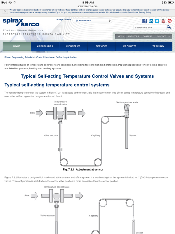

That's pretty much what I'm trying to accomplish but I need it to close at a lower temperature. Since other similar devices exist I might as well spill the beans since I'm not going to get rich. I'm trying to activate a water shutoff valve when it gets below freezing. I'm hoping to use no electric before most of the other versions do use electric and I'm hoping that with spring assistance it will turn the water back on when it warms up.
   / What liquid expands the most with a temperature change? #12
Use water then. It expands when frozen and will contract at room temp from frozen size. Make your own cylinder out of some plastic pipe. Test random sizes, I would start small diameter so it would freeze before valve. Like tow sizes of pex ? Or maybe even a rubber diaphragm with some sort of gas in it? You could pull the valve instead of push it?
   / What liquid expands the most with a temperature change? #13

By that point my water lines are already frozen.
Quarter turn water valves take more pressure than you may realize so size your cylinder commensurate with that issue.
Ron
