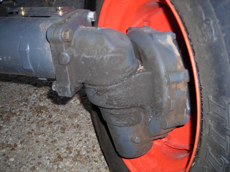

Here's a photo of what I am seeing on the front axle...looks like a leak to me....
   / What lube is in your L3X30 front axle?
RaT:
Ive never had a MFWD tractor before so maybe this is normal and Im just overreacting...I just assumed it was a leak. Does your front axle look anything like this?
   / What lube is in your L3X30 front axle? #9
Not sure, but that doesn't look like a leak to me, the inside of the wheel is totally clean, you'd think if there were a leak it would be all over the inside of the wheel too. Looks about normal to me.
How much fluid are you actually losing? Be sure to leave room for heat expansion in the front axle by NOT filling right up to the fill bolt.
The best way to insure that those seals last a long time is everytime you get finished using the machine, take a hose and spray off the top of that joint with water and get all the dirt and sand off and away from those seals.
Allowing dirt and sand buildup on those seals is NOT a good idea.
