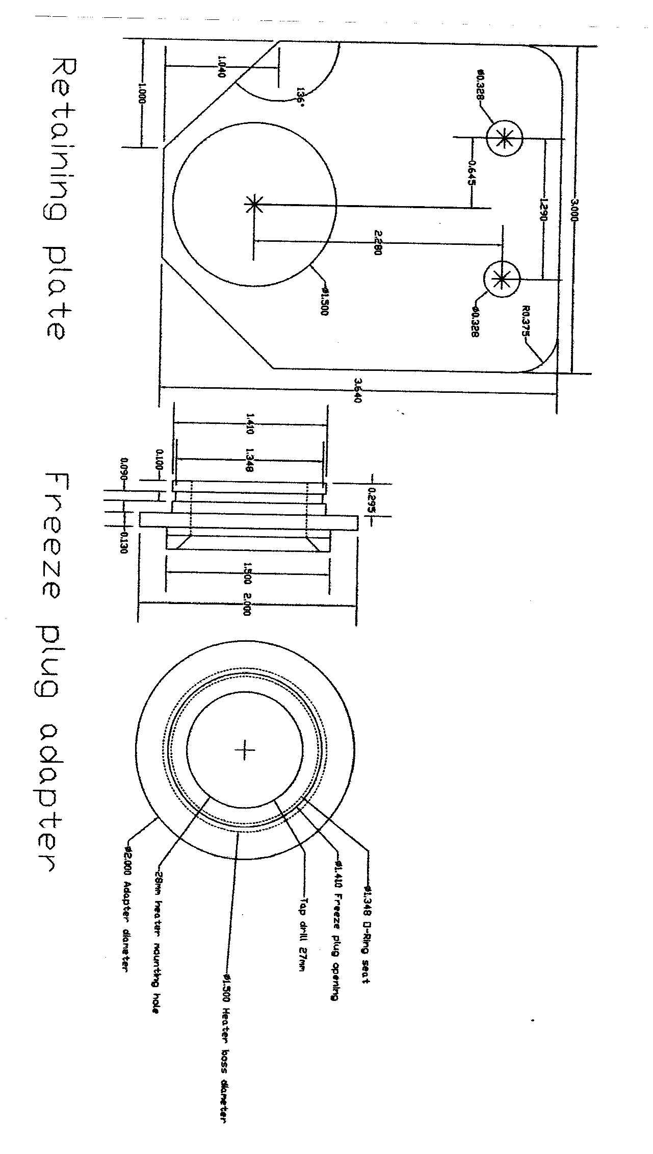

Adapter drawing
I uploaded a AutoCAD drawing of the adapter. When I get my camera working I will take a picture of it and post that. There are two 28mm heaters, one with a 1.0mm pitch and the other with a 1.25mm pitch available from Zerostart. The heaters come with an aluminum gasket. I don't like gaskets so I used o-rings on the adapter at the freeze plug opening and the heater. The one at the freeze plug is 1-1/4" id, 1/16 thick. The one on the heater hole is 1" id and 1/8" thick. When looking at the adapter drawing the largest diameter is 0.130 thick. This is the space between retaining plate and the raised freeze plug boss. That is the most critical dimension because it holds the adapter in the hole, which is not machined.. The retaining plate is 1/8" thick and will flex a bit if the distance is off to the narrow side. But I don't think that would matter but if it does shims could be placed under the plate at the plate mounting holes or on the adapter to make the fit snug.
I hope this helps anyone who wants to make one. I don't know if it is worth my time or be cost effective to fabricate these individually. To make a profit and keep the cost down I would have to be able to make it in an hour and charge $50 for it. I don't think it could be done in that time. If anyone wants to do that feel free to use the drawings.
I built it because I am cheap and don't like the idea of paying 3 to 4 times what a regular heater would cost at an auto parts store. Besides I have to tools and like to tinker.
Cheers,
Barry

   / What model block heater fits a GC2400? #15
"I built it because I am cheap and don't like the idea of paying 3 to 4 times what a regular heater would cost at an auto parts store. Besides I have to tools and like to tinker."
I hear ya, Barry! I've often wished I had a machine shop, as I often find myself making things like you do.
When I bought that heater I also had a bit of a bad taste in my mouth afterward.... can't believe it has more than $10 in materials in it. I just try to rationalize it (and not think about it too much)...:eek:
Thanks for the drawings, and I'd love to see a pic of it.

Thanks razz for the drawing, it appears to be what I had envisioned.
Zero start has ignored e-mails in the past, which doesn't make me want to deal with them either. Perhaps if enough GC owners were to ask them, they would offer a heater. That is if they are not already under contract to make the ones that MF is overcharging everyone for. :laughing:

Since there is no way to put one in the block with a butterfly tightener their cost would probably be about the same you at MF, if not more. They would have to make something like I designed and like the one MF supplies. There would have to be a high demand for them to tool up for it. I doubt it is worth bothering them about it. The retaining plate could be stamped but the adapter would have to be machined.
One thing I did not try but that would make it easier to build would be to put the retaining plate on top of the heater flange, using o-rings on the plug and heater joints. That would not require threading the adapter and would be much easier to build. I build a lot of my own hydraulic parts and just get in the habit of threading o-ring connectors. I didn't event think of doing it the easy way until now.
