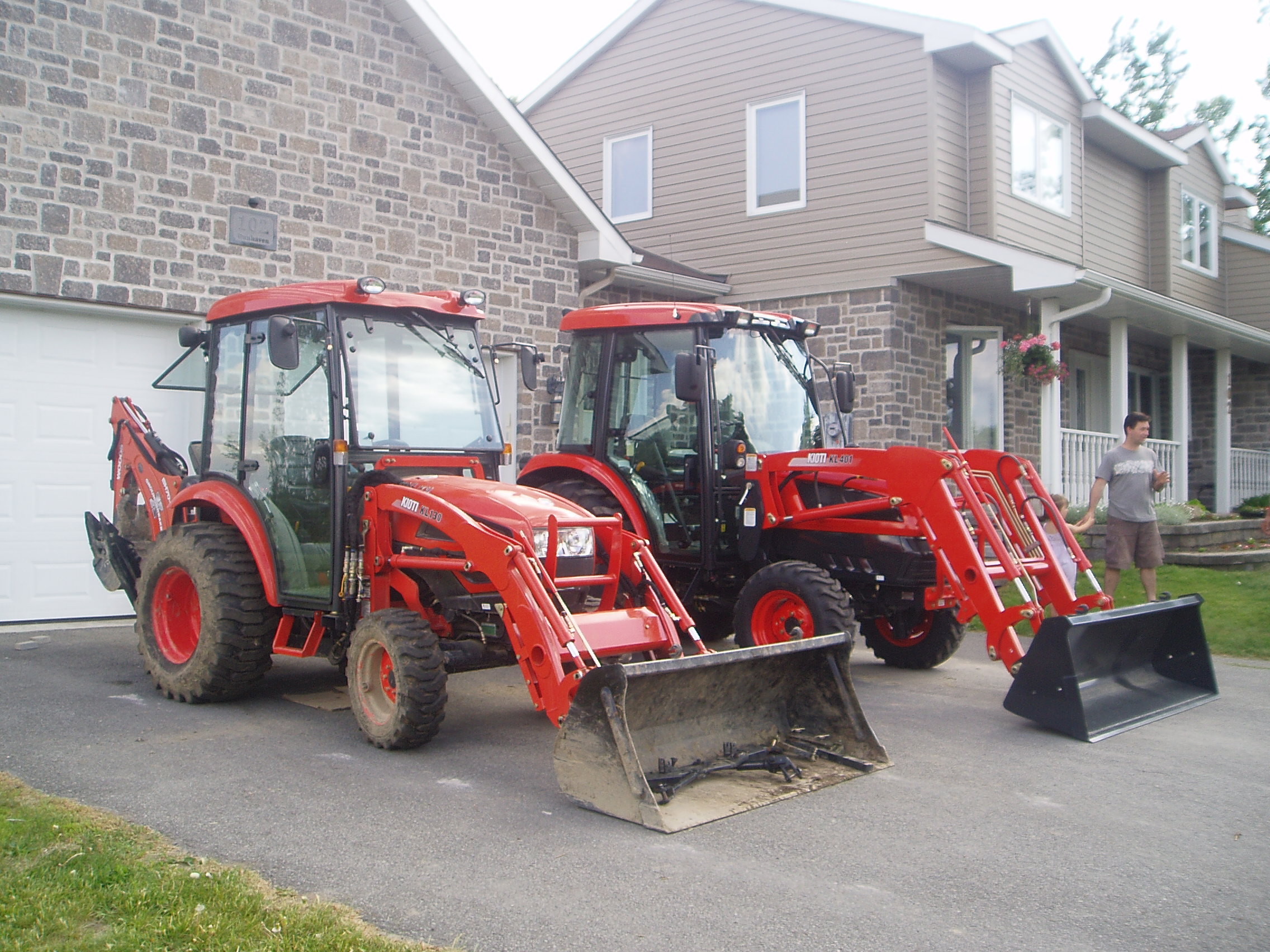

Well, the CK or DK series will do all of these jobs, it just depends on how fast you want to do them. I would suggest either a CK30 gear or DK40 HST and here's why:
CK30 gear: I had the HST model. They're a beast of a tractor for the hp and will do all the jobs you've described. They are a little smaller than the DK so they'll get in the woods a little easier. I would only buy a CK gear for two reasons. Do a search for sticky hydro pedal here on TBN, you'll find a lot to read. I had the problem and my dealer had to split the tractor and replace the hst. I think it's a very wide ranging issue with these tractors and is enough of a reason to only go gear for me. The other reason for gear is that the CK30 doesn't have enough hp to use the high range and a gear trans. is more efficient and will give you the power you need to move all that weight. I'd choose the CK30 over the CK27 because it's (was) only about an $800 upgrade and I'd choose the CK30 over the CK35 because it's (was) about $2000 less. That said, they are all identical tractors with more or less hp and your local dealer may be able to give you a better deal one model over another based on their stock.
DK40 HST: This is the one I would really recommend, even if you don't really need it. The FEL is 2.5X stronger (I found the KL130 on the CK a little weak), it's 4 cyl vs 3, independent PTO vs Live, much more electronics including 4X4 and gauges, more 3pt cap., steering brakes, draft control and a lot of other smaller differences. For me, a $4K diff. in price is well worth what you get. There have been no reports of HST issues with the 2 pedal set up on the DK verses the rocker pedal on the CK and mine has been perfect. Again, the DK45 and DK50 are the same with more hp and your dealer may be able to get you a better deal on one of those. The DK45 is 4 PTO hp more than the DK40 but only 1.5 PTO hp less than the DK50. I started wanting a DK50, but my dealer could do better on the DK45, and it's really close on the PTO anyway.
Good luck and keep us posted.
P.S Here's my CK30 HST beside my DK45 HST.
