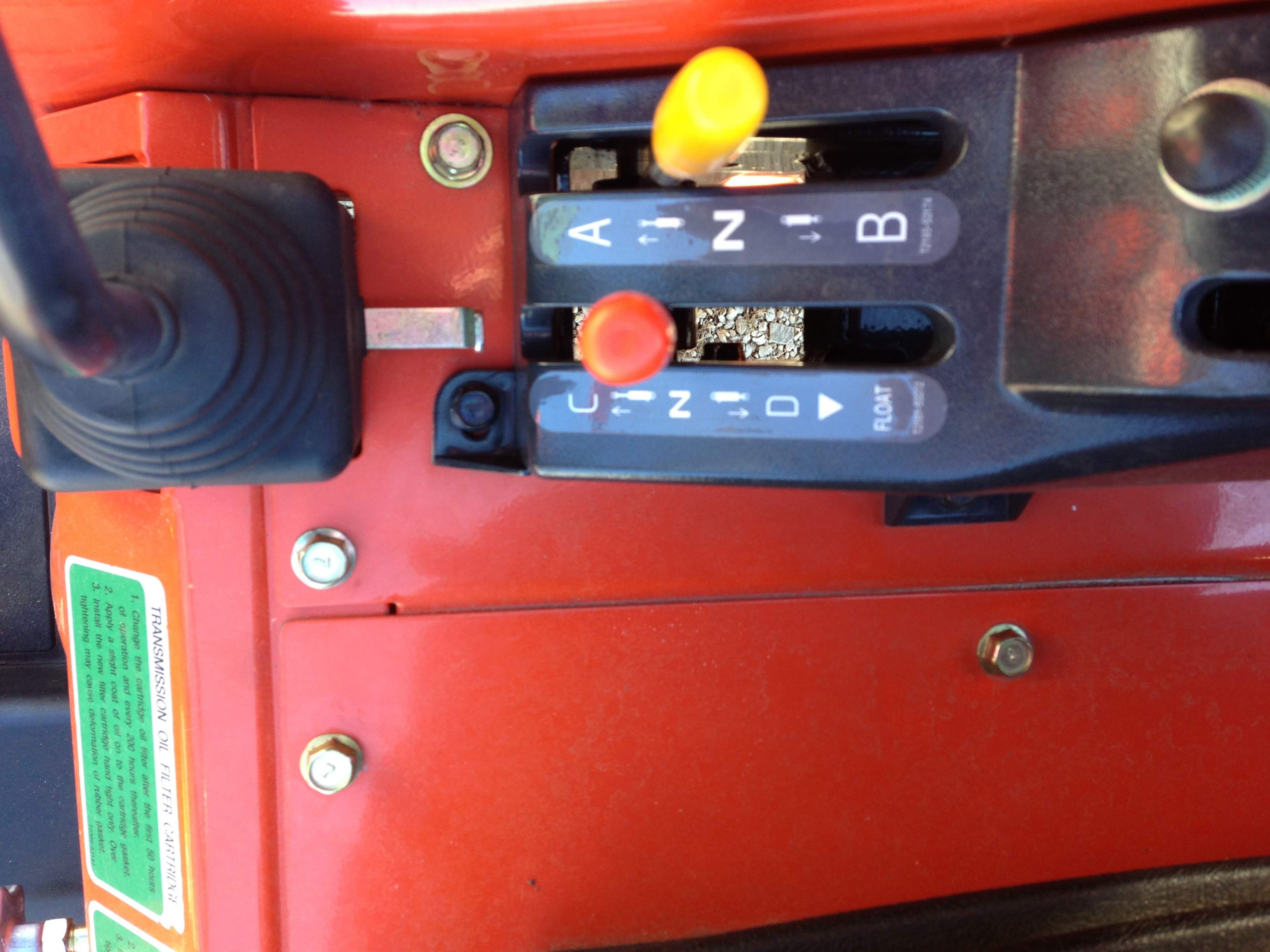

Remember to get that 2 rear remote, and be sure to get it with the float function. It is available, just need to push for it.

MtnViewRanch, pardon my ignorance, but what would the rear remotes be used for and what is the purpose of the float function? I'd like to get this purchase right the first time, but still have a lot to learn.

The rear remotes are for operating things like powered top and tilt functions on the 3pt, log splitters, stump grinders, rear snow blowers, etc.

As far as the float function with rear remotes. If you have this function, it can be used with the top link when mowing. Yes some mowers have a swivel point on the mower itself that does the same thing as using the float function. But a couple of things regarding this. All mowers do not have this swivel bracket and even if it does, if a person is mowing steep terrain, there are conditions where even the swivel bracket does not allow the mower to move enough for the mower to be able to follow the ground.
Use of the float function with a hydraulic side link allows for the implement to float (tilt) side-side. This can be a nice feature when finish grading-smoothing a drive or even when raking an open field with a landscape rake.
Once a person uses hydraulic features on the back of their tractor, they often find that they want more. Best time to get these remotes is when the tractor is purchased IMO. ;)
