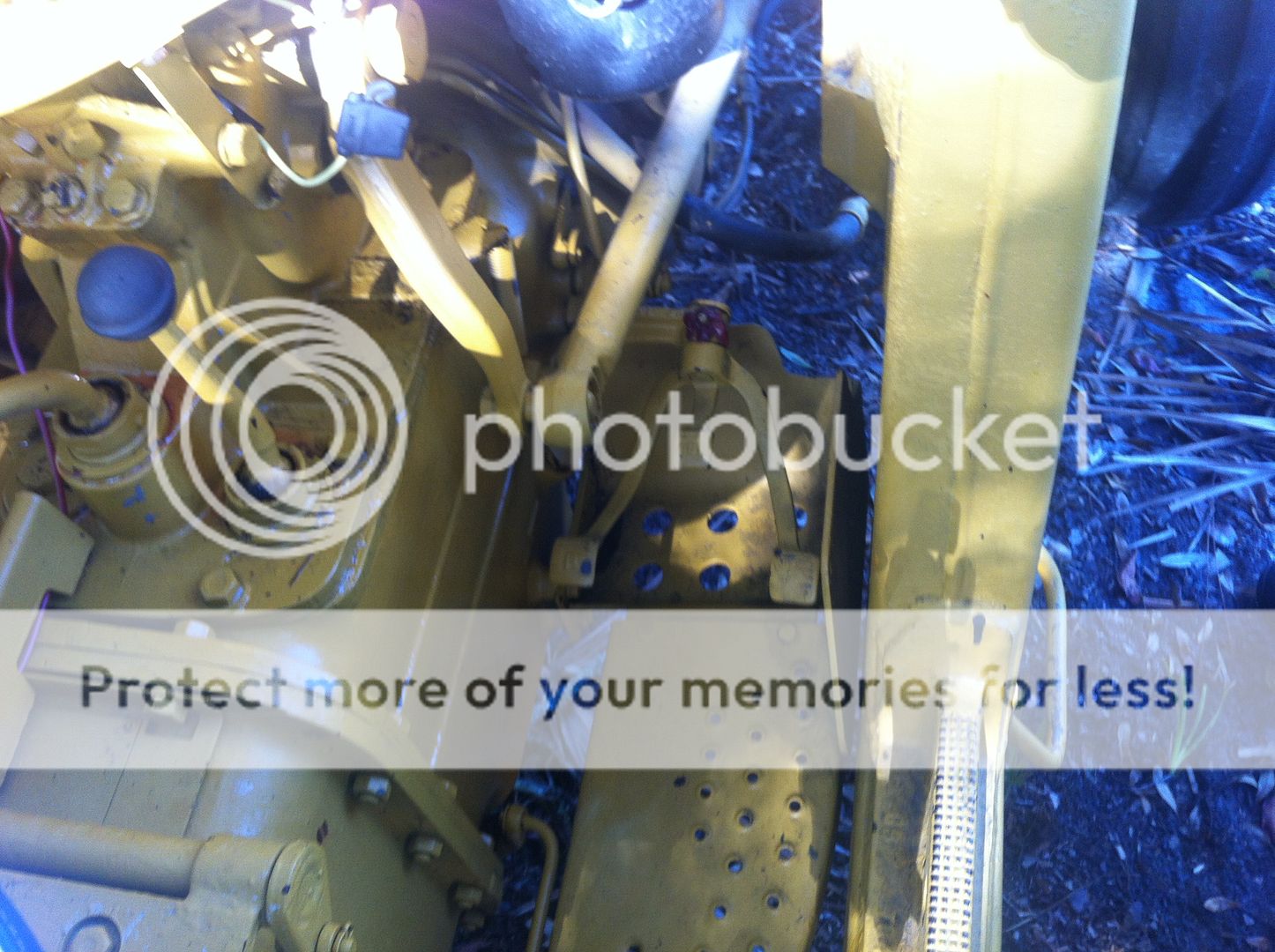

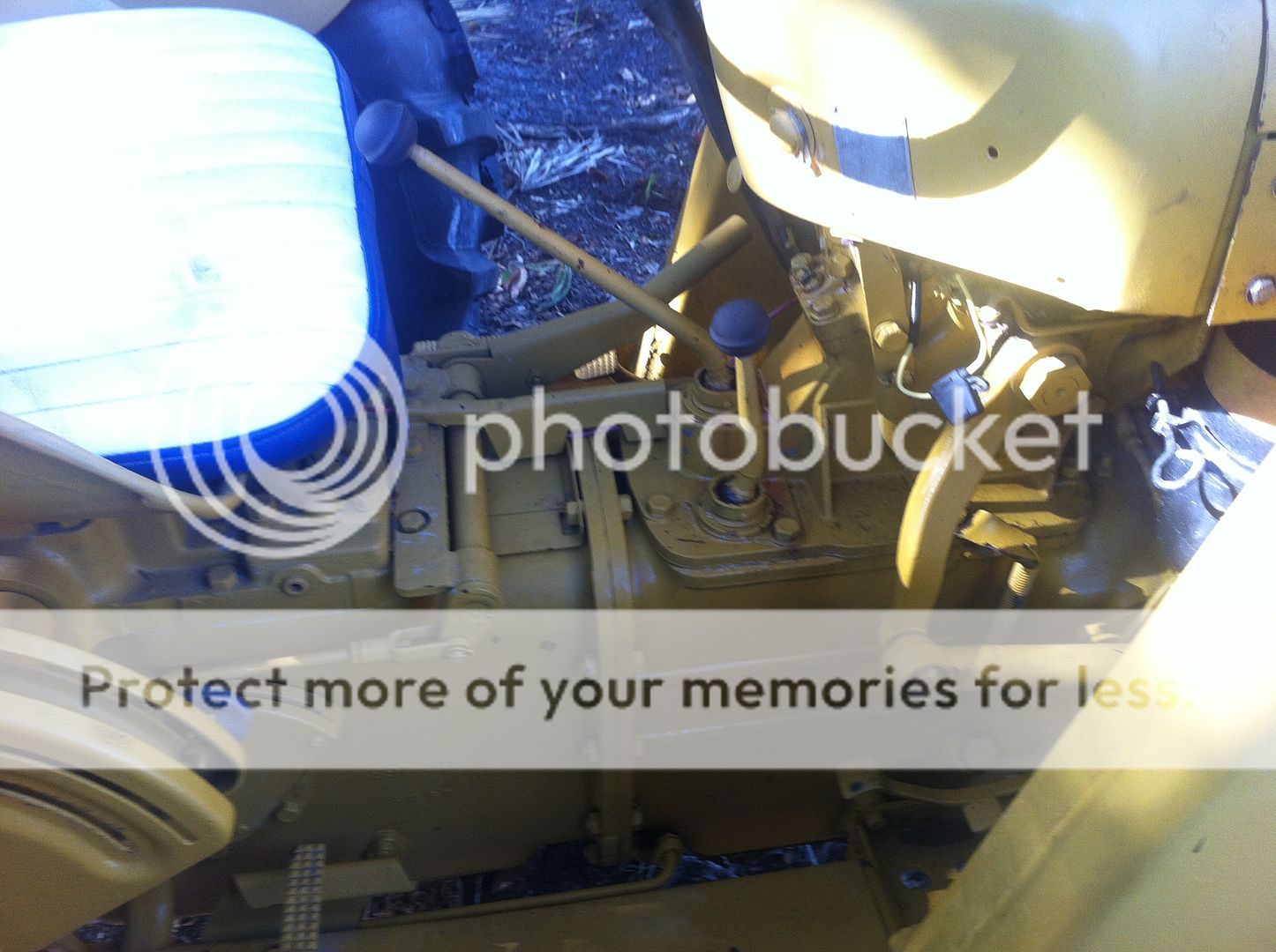

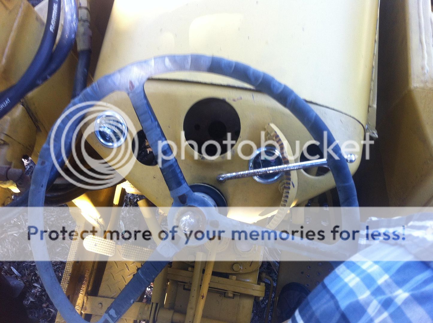

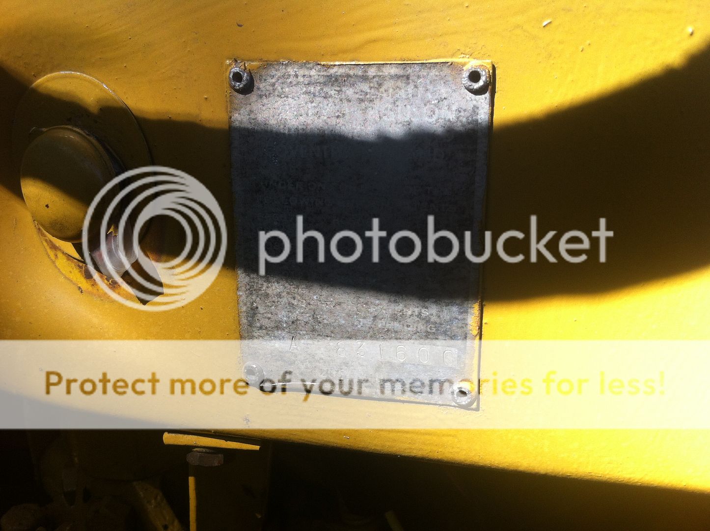

Forgot to mention took a few more picks of it. Really need to identify what it is so I can start searching for the small few parts it needs. Most importantly the shifter boots, before more water leaks into the trany.
   / What model? #12
G'day the shifter boots look like any of the 35/65/100 series ones so any good aftermarket tractor spares place should be able to help you out with them as for moving the hyd controls across the other side just weld a plate on the loader upright and away you go.
Jon
   / What model? #13
Looks to be MF 203 INDUSTRIAL MODEL
   / What model? #14
It's hard to tell even with the serial number what the exact model is, but it is a 200 series Work Bull with a torque converter, and instant reverse (the two pedals on the left, "do not" push both of those pedals at the same time). Regardless you need (2) AGCO 180579M3 shifter boots.
