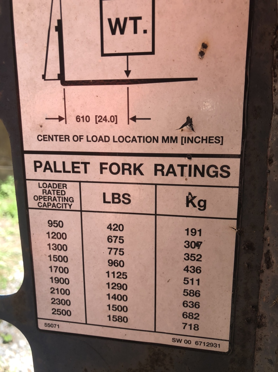

Sticker on Bobcat forks.
   / What pallet forks work on my tractor?
#14
I guess I see how that tells you how much the forks can take but not what size/horsepower tractor they can go on unless I’m not reading it completely.
