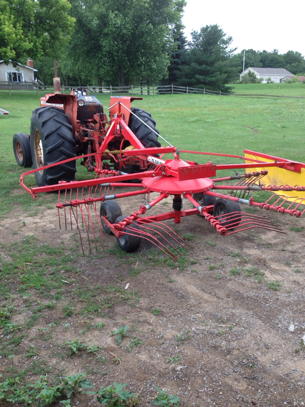

Rotary worked great for me in last years thin hay, We used a roll a bar and the drying time in the rotary was well worth the $$. The AC's hydraulics work great so it followed the contour of the land. Also changing the pto speed makes a difference in the windrow density.
