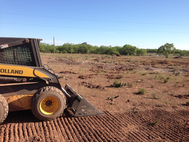

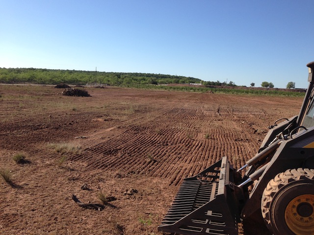

I finished grubbing 20 of the 33 acres that my customer wanted me to clean up. He asked me to stop grubbing and go ahead and rake the 20 acres into small piles so he could burn them before a burn ban was put in place.
The 20 acres of grubbing took a little over 46 hrs. That is an average of 2.3 hours per acre. Not too bad I think.
The raking is another story. I am using a rock bucket, as I cannot seem to rent a root rake for the skid. No rental companies in the area have them available. The only way I can use the rock bucket is to angle the tip down and run backwards. It is much slower than I thought. I thought I could make an acre an hour raking but it is more like 2.5 hrs per acre. So far I've raked about 7 acres. I had a chat with my customer it looks like I am going to build a root rake. I will space the tines a little closer than normal so I can pick up smaller debris than a normal root rake will. The other problem with the rock bucket is that it seems to pick up way too much dirt.
Here is a picture of the pasture after grubbing and before raking
And after raking
