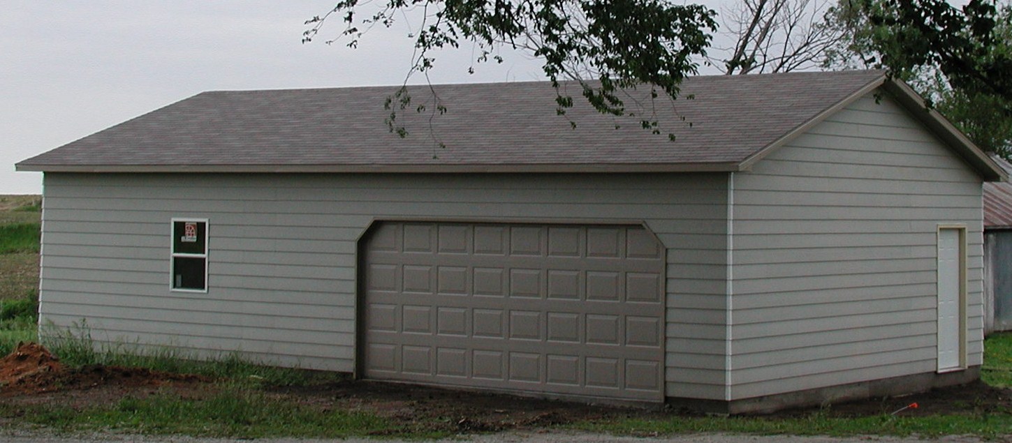

I just finished a stick built for 20K it is 24 x40 and like everyone says, bigger would be better. This one is in accordance to the specifications of SWMBO as it is close to the house.
The large overhead door is on the end. I do believe that a pole building would be better suited.
