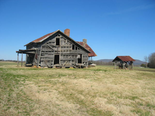

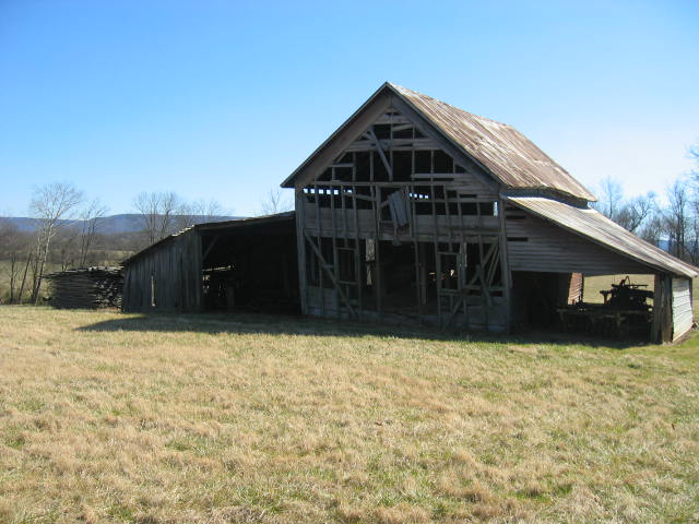

I had a guy about 4 years ago take down an old house and barn for me. He charged me I believe around $2000-2500 to do it (can't remember exactly) He demolished the buildings, burned and buried the remains - and saved me the rock from the fireplace for various projects. Now you can't tell there were ever buildings even there. I hated to take down the buildings with all the family history behind them - but they were getting pretty hazardous. I thought he gave me a great price for the quality of his work.
