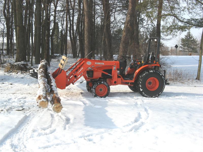

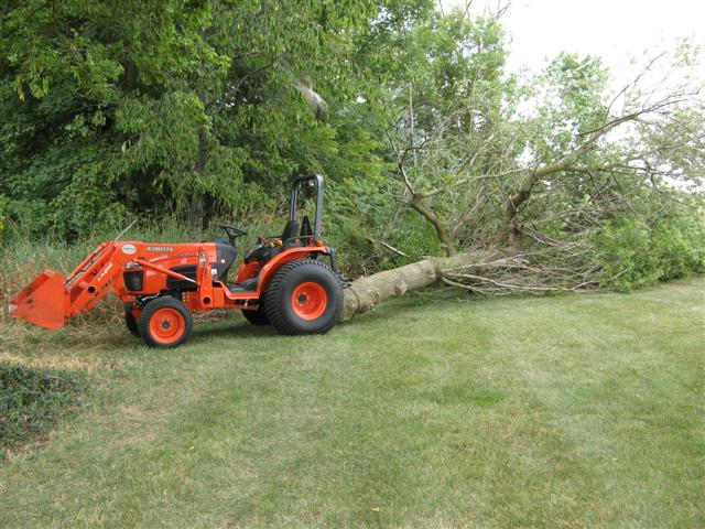

I can't think of anything larger than a Kubota B3200/B7800 that would do the job, and come under your weight limit. Remember that the weight of the trailer has to be figured in there too. You will most certainly want the rear tires loaded with rimguard, you will more than likely want good chains, there is the weight of the Farmi, etc. Eventually, you will probably see the need for more overhead protection, and that will add weight too.(Look at the forester in a recent Kioti thread) In your situation, more weight is probably a better thing, but a lot of skidding, and brush handling has been done by the B series tractors. I have a B2620, and that weighs a little less yet, but perhaps not enough less to justify it for your use, on the other hand, the tires are smaller, and that would cut the overall weight a bit too. It is not, however, a good idea to have a tractor lighter than the log you are dragging. With a Farmi, I would probably hitch up to the kind of thing you are talking about, but use due caution. There are no quick attach forks readily available for it either. Here is one picture that a member submitted showing that size B tractor pulling a tree, and another showing the use of home made forks. Bear in mind that this land is level, and open.
http://www.tractorbynet.com/forums/kioti-owning-operating/132884-kioti-forestry-worker.html

The trees in the loader bucket in the picture above by chuckinNH are what I'm talking about. The other picture of the big tree behind that little Kubota is not something I want to do often. I know tractors are not designed for woods work but it can be done if you are careful. A 30 hp tractor might not weigh much or be able to lift a house.... BUT, it's better than what I have now,,,, which is NOTHING! I fully expect to be limited to what I can do with a tractor this size.
Understood, just my two cents.
