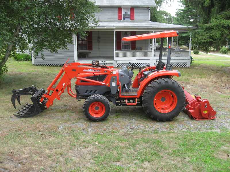

Ditto, that is exactly what I was thinking as I read through this thread. The B3030 cab and a flail mower would be a very nice and compact arrangement for finish mowing. I'd probably look at something a bit heavier if there were more ground engaging tasks but for a dedicated 11 acre finish mower the cab B3030 would be the cat's pajamas (and least expensive A/C cab I believe too).
Flail mowers do a very nice job and are pretty close to a dedicated finish mower in cut quality while being a lot tougher and more compact. You need to look for a medium or light duty flail like a Caroni to compare favorably to the good finish mowers on price though. A six foot Caroni costs a bit less than a six foot premium brand finish mower. Heavy duty flails are very expensive.
