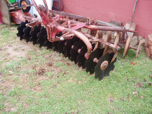

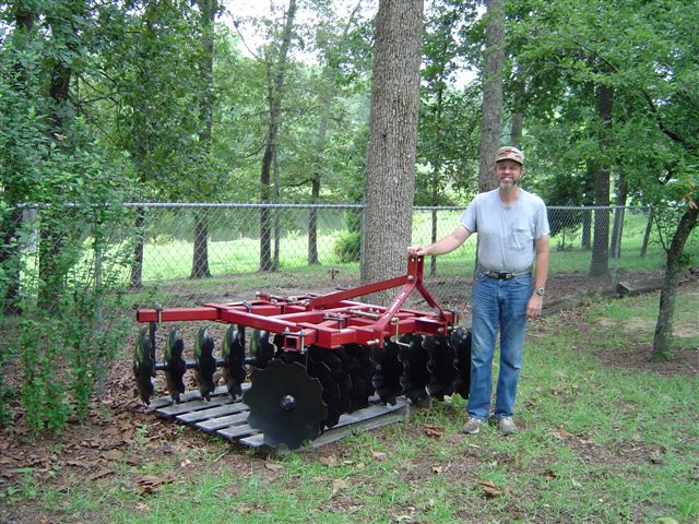

Hi Travis,
I recently bought a new disk after shopping around and asking opinions, (just like you). Hardee and Leinbach are good quality disks. A couple friends recommended getting the screw type gang adjustments. I got a Leinbach, (screw adjust). I am very satisfied with it. I got the 20" disks, 20 by 20. I paid $950. I also noticed that Hardee can be ordered with the screw type adjustment. Screw type is what I recommend for the gang adjustments, instead of a hammer or big piece of pipe the others sometimes require.
You want your gangs to be adjustable! When disking, I adjust the gangs at a steep angle to dig and turn the soil. Then spread your food plot seed...then adjust your gangs straight to smooth the ground out and cover over your seed, (if you don't have a drag).

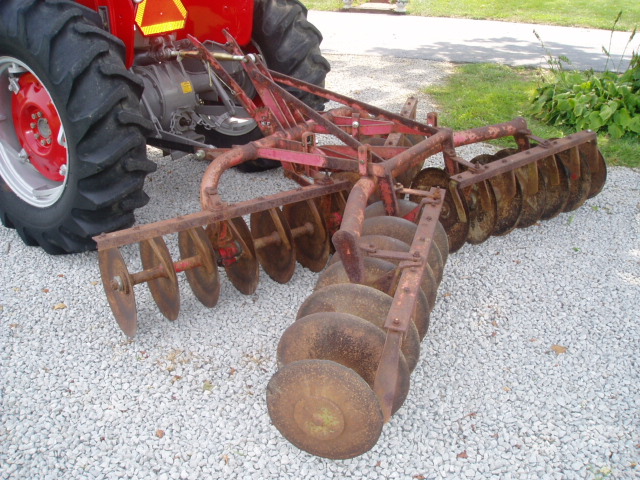

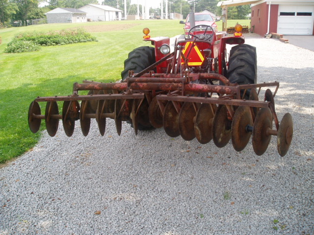

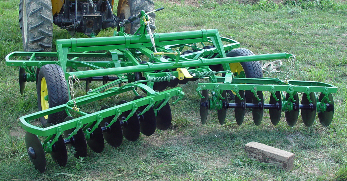

Travis, depends a lot on the lay of your land, hilly, flat, sandy soil, etc.
I have a 36hp cub cadet 4x4 that I pull a 10' JD KBA harrow disk with, 1st or 2nd gear high on completely flat ground, low range 4 with hills. It's a wheel disk that I completely pull the wheels up on. I'm sure I'm at my very maximum for size. I have a good loamy top soil that I usually wait to work after it has some moisture in it.
Sounds like you want a 3-point implement. As others have stated, a 6.5' fixed angle disk harrow should not give you any problem. If you want a disk plow, then that may be a different story.
Just on a side note, I went with a 6.5' box blade on mine to cover the rear wheels and have not had any problems pulling it except ripping the rear lower supporting pin for the lower lift arm off when I snagged a rock and faield to stop the tractor fast enough.

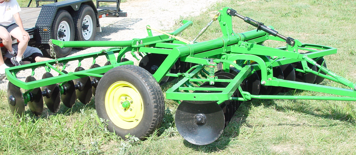

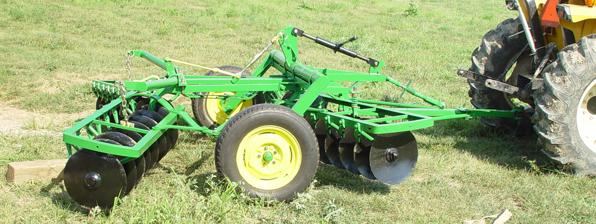

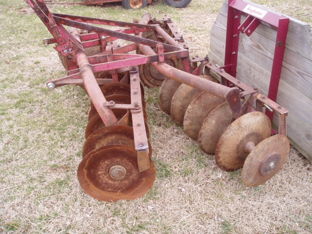

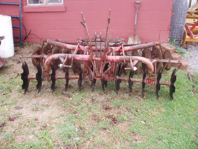

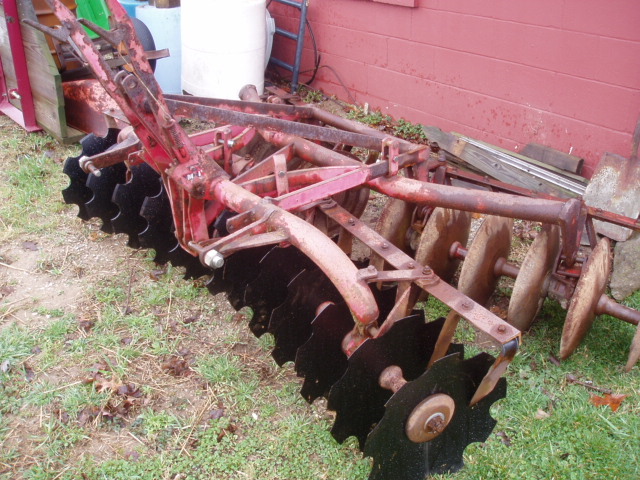

Now that you're a MASSEY owner, you might want a Massey disc! One of the best performing 3-point disc's ever built was the MF #25. They were in production from the early 1950's until the late 1980's. Literally MILLIONS of them built and sold. Many still exist. They'll be used and likely a bit of rust, but they still work as good as any disc you'll find. They were built with the Massey FErguson utility tractor in mind. They're short-coupled for ease of handling on the hitch of a relatively light tractor. The pair of levers allows on-the-go adjustment of gang angles. A simple removal of one bolt per gang allows each gang to float independently. They dig like a much heavier disc. Anyone who's ever used one will rave about their performance. They do an incredable job of leveling a seedbed. I heard all this for years and years, but never owned one. Last year I bought one to fix up and re-sell. I used it for a day and sold my IH wheel disc that I'd grown very attached to. Planning on re-furbishing this one during the upcoming winter.
I bought it as an 8'-10" model. By cutting down the axles and removing one blade and spool per gang, it's now a 7'-8" model. Can be reduced to 6'-6" by removing one more blade/spool. Some of the disc blades were worn. I replaced the front blades with notched. Be carefull with notched blades. They do tend to break easier if and when you hit a rock.
Whatever disc you choose, I HIGHLY recommend disc scrapers.
