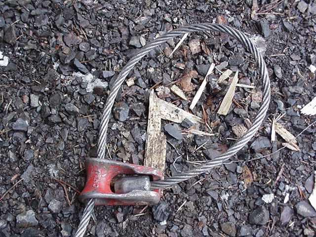

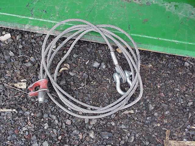

I have some pics to post of the chokers from Bailey's. I have read a few posts about dangerous cables, etc and yes, they will break and snap but so will chains. I live in a logging community in NE Oregon and I talk to loggers, my friends are loggers, and I live next to loggers and ALL of them use chokers and not chains, ropes or straps. Whether they buy locally or order from an online company, they all use choker cables in various configurations and lengths. Yes, the cables will get frayed from rocks but they are much cheaper than chains and gloves (as I am sure all of us wear) will save your hands.
The first is the 12' choker I have and it is 2 years old. I have skidded more logs than I can remember and it is a little frayed but will last many more years.

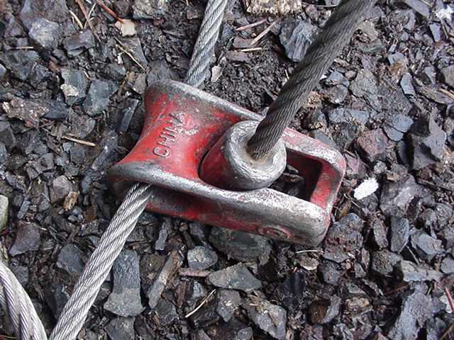

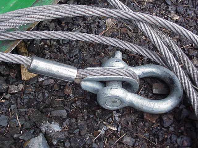

Closeup of end. You can get different size ends or have swedged ends to connect to bells on a winch line. I just drop this over a large hook on the drag bar on the tractor.

The swedged end is brought around the log and inserted into the bell. It lays into the slot and forms a loop. You can bind many logs together as it cinches down and holds them together when you skid. them. Release the tension and it comes apart, unlike most chains.

Closeup of the swedged end going into the bell. Very easy to do, especially when you are logging in 1-2 feet of snow and ice.

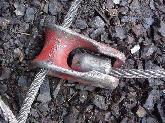

Closeup of the swedged end in the bell. The bell slides up and down the cable so your loop can be as long as you like. When you set the choker, you set it on the side or down low. When you skid the log, it spins the log up so you can "bump" the knots (limbs) off the underside. I am sure there are many options and people have their favorites. These are cheap, light, safe (IMO) and quick to set. As I said, get different lengths and you can skid 3-5 logs at a time to the landing. Hope it helps and I am sure this will generate more opinions. /forums/images/graemlins/grin.gif

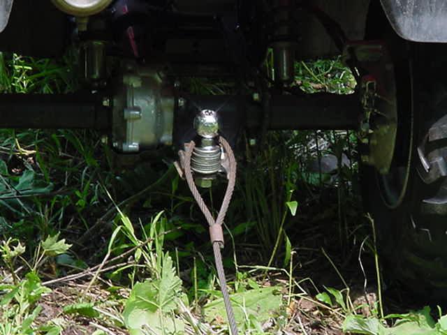

Appreciate the pictures. I also have cable chokers from Bailey's, used them when skidding pulpwood logs with my AC H3 a few years back - IMHO easier to work with and safer then chains.
Had a small firewood skidding project this summer and rather then haul the H3, decided to try the Honda Foreman 4x4. Worked like a charm. Trees were pole wood size, up to 10" in diameter and tree length.
Found a few pictures so will post them for what they're worth. I ordered a couple of chokers with a loop on one end, worked good on the ball hitch. Made up a setup for my crawler, will post a picture of that in the future - could skid several logs at one time, from scattered locations.

cable choker with loop on one end.
penokee /forums/images/graemlins/smile.gif
