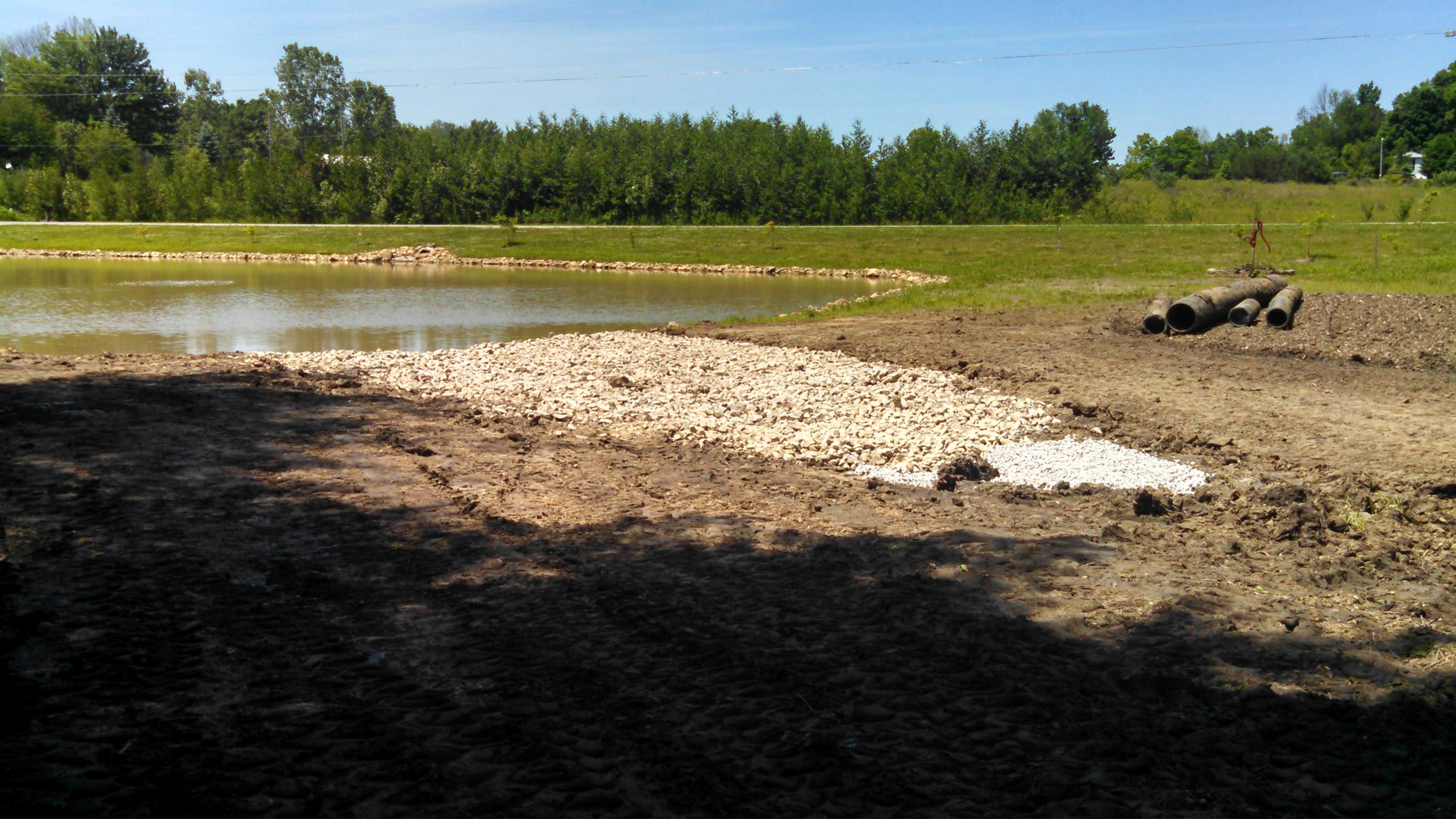

I used 1's and 2's of limestone for a pond overflow that carries alot of water. I like the end result. It is solid to run over even with water flowing over the top. It isnt bad to walk on or drive equipment on either. But if you dont have much clow that will wash away smaller stone, you could always top that with 57's.
Here is 10 tons.

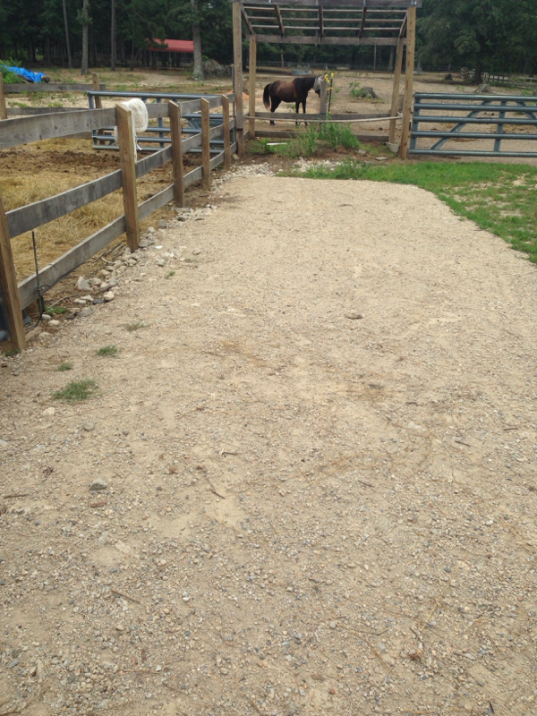

Ken is right about the the bigger rock. My barnyard had gotten so bad through the years that it was impossible to move through it without sinking.
I scraped a 10' wide area around the barn and add #3 RCC in about 6" thick. Packed it down with the backhoe. I waited about a month and then put more to get to the grade I needed. The boarders grumbled for about 2 more months about having to walk on that big stone. Then i put a layer of crushed concrete on top. I wet it down and worked it into the base with the backhoe. The whole area has tightened up to where I can drive the hoe on it on the wettest of days. The boarders love it and try to keep it clean. We pickup any manure or waste hay and every so often I rake it with a leaf rake to get any debris off of it. It has stayed fresh looking for a year and I have not had any settle spots or pot holes in it.
The big rock is the way to go. Put some in and watch it settle put some more in and don't rush it. I learned a lot when I built my road and took my time. I knew I didn't have to turn traffic loose on it right away.

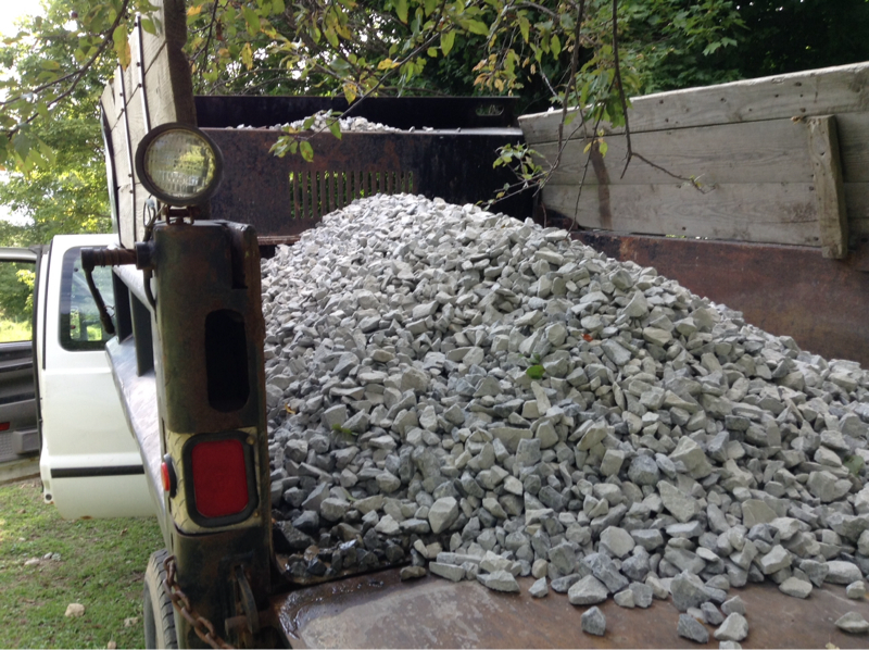

Follow up: I used a #3 stone (about 2-3" dia.), small enough to walk and drive on, big enough to let a lot of water through without a pipe (I hope). $33 for 3 tons.

   / What size crushed stone? #18
Hope it works well for you. Did you put anything under the rock?
#19
No. I only ended up using half the load, so if it sinks I'll add more.
Time will tell if this was a mistake. My biggest concern is if it fills up gaps in stone with dirt, then digging out a couple tons of stone will be a pain.
   / What size crushed stone? #20
I think that will only happen bad if your in an area where the ground freezes and turns to mush in spring.
