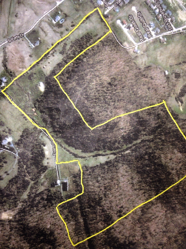

Long time lurker here and about to purchase my first tractor. My question is more of what size do you guys think I may need as opposed to what brand. I'll worry about that later.
I'll try to give as much details about the land as possible. I have about 4 acres of lawn all on an incline that I have been mowing with a riding lawn mower for the past 7 years but I thinks it's just too much ground as that machine died this year.
I also do some landscaping and could use a bucket along with a MMM. Also, I'm closing on a 101 acres Oct. 1 and I have included an aerial map below. Everything not covered by trees is well maintained and decently level with a fair amount of fruit trees.
I would consider the dark green area to be "lawn" and the rest is cut for hay. The tree covered areas is all rugged terrain but I probably won't do much with the tractor there. Maybe some brush hogging behind the "lawn" area. The lawn area looks to be about 10 acres. The fields maybe a generous 15-20 acres.
Will obviously need either a rotary cutter or get into the hay cutting for the fields. So that would put me with needing a finish type mower, rotary cutter, FEL and probably a hoe in the future.
I'll be financing the machine and looking for 0% interest deal and would hate to go over 20k on just the tractor and mower for now. Will had the other attachments as I go. I know I'll get a better deal if I combine everything into a package butim just looking at the monthly price to stay low for the time being.
I was strongly considering a SCUT (John Deere 1025 with 60" 7-iron auto-connect deck and a rear blade combo for about 14k) but after a lot of reading, it seems that may be too small? So, what do you all think? Thanks in advance! image-3867058770.jpg

The 4 acres of lawn and the 101 acres tend to place opposite needs of what tractor size to recommend. If the 4 acres lawn is open and relatively free of trees and shrubs, then I would be looking at a 30 pto horse power tractor. I would suggest looking at a rear mounted finish mower to hold down cost and getting the front loader with the tractor. The front loader will prove to be very valuable.
Carefull shopping should get you the tractor, front loader and rear mount finish mower as a package. If you purchase from an out of state dealer you can avoid sales tax and still stay at your $20k limit,(Barlows Kubota in Kentucky for instance).
Will obviously need either a rotary cutter or get into the hay cutting for the fields. So that would put me with needing a finish type mower, rotary cutter, bucket and probably a hoe in the future.

Are you going to build and move to the new property or keep both properties. How close are they? Will you be able yo drive or trailer equipment back and forth?
if you are never going to log out the woods, you go lighter than if you are going to log and build a road thru the woods.
for the price of a mmm, you may be able to get a dedicated mowing machine with about a 60 inch mower. Then get a tractor loader for the 100 acres with the balance of your budget.

I will be keeping both properties, might build on the 100 acres later down the road. I live on the 4 acres now and the 100 acres has a small house, a garage, barn and storage shed. The properties are about 7 miles apart.
I figured trailering between the two or just store the tractor at the farm and follow the advice on here and just get a dedicated mower for the 4 acres.
50hp?, that's a big machine for sure. Thanks to the hay cutting advice, I think I would rather use the 15-20 acre fields for a deer food plot.
I went to the local Kubota dealer this evening and looked at the L3800. I think it's a 30hp to the PTO. I have seen some nice package deals with the tractor, FEL, rotary cutter, box blade and trailer for around 22k. Seems like a pretty good deal.

If you will be moving ROUND hay bales you will need a tractor with 50-hp and a Front End Loader, minimum.
Small round bales are 1,000 pounds, larger ones 2,000 pounds. Loaders for 50-hp tractors will generally lift around 2,000 pounds to full height, when new. You will probably need to stack them two high at some point.
With a 50-hp tractor/loader you can pull 72" and 84" implements.
Trying to work your fields with 60" implements behind a L3800 will get old after day three. It could be done but other work on your property calls every minute you are in the seat.
L3800's LA524FL FEL has a lift capacity of 1,500 pounds, when new. Not enough for Round Bales.

As someone with some experience on "small" West Virginia hay fields I will agree you're looking at several times that $20k to get into haying your property with new hardware. Anything under 50HP we've used to run cutters and prep tools, to do the round bales it takes 70ish HP to manage the hills and a full baler, and then sometimes it is still a struggle. If you have really nice hay worth doing square bales, 50HP would be fine.
I think your deer food plot is a good idea. You might also do well to talk to others around you. Many times someone who needs the hay will come do the fields and take the hay and you don't need to worry about it.

I would get a ZTR mower for the lawn mowing. A 52-60" mower in commercial or near commercial grade will mow 3-5 acres per hour if the ground is smooth enough to run at full speed (HST Speed-engine should always be at full speed) I mow approximately 6 acres with my Ferris IS 700 with 52" deck in about 2 hours at a leisurely pace. Cant run full speed due to ground being too rough.
Haying might be practical if the whole 102 acres was in grass, but even used equipment on 50 acres or less is too expensive to justify tying up $30K+ for a round baler, rake and cutter not to mention the tractor cost to pull it. New round baler, 70+ HP tractor, tedder, cutter> you are looking at close to $100K.
A 40 HP or thereabout is likely all you need to bush hog, pull out the occasional tree, move a round bale (after someone else cuts and bales) and do other miscellaneous chores. MY Brother in law routinely moves round bales and stacks them 2 high with a New Holland T2310 Boomer. I had to use my LS P7010 to get the 3rd level in place but 2 isn't a problem and 3 can be done if the bales are light like after setting for 6 months and drying out.
You may bust your $20k budget getting a commercial or heavy residential zero turn and a 40 hp tractor unless you go used on the tractor but it wont be by much. My Ferris was $6200 with taxes included so you would only have about $14K for the tractor and I think you would need at least $18K for a new one and to get 0% financing you will have to go with new. Many mower dealers are also offering 0% financing.
