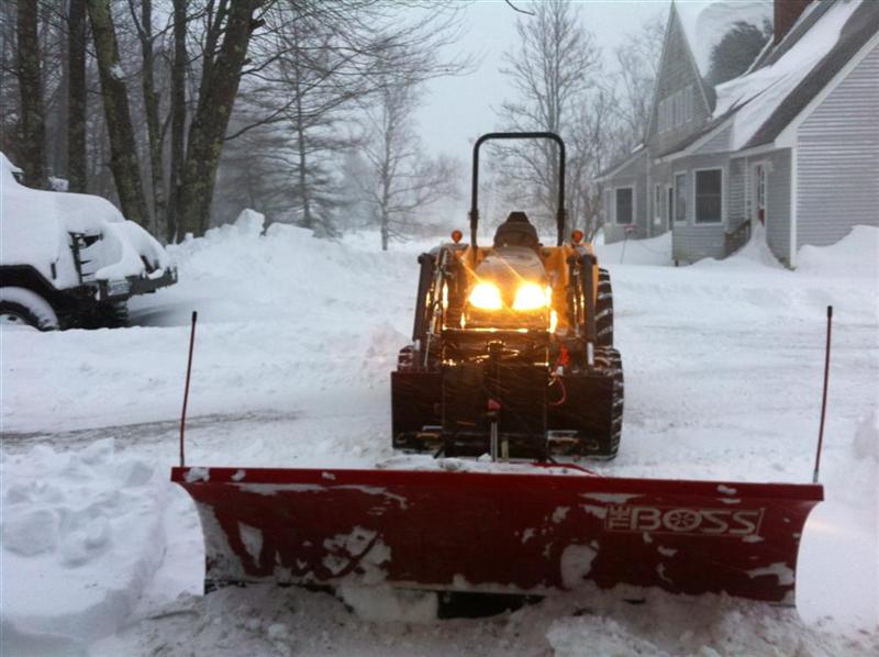

I'd suggest compromising and go with a 7.5 foot plow. Our tractor/loaders are similar in size in weight, this what my 7.5 footer looks like from the front. Granted it sticks out a little further then a loader designed plow because its made for a truck. It pushed 2 feet of snow pretty well (Ag tires) but I can see why others would go with a seven footer. Also, do you have a garage? This plow just barely fits through my door without angling it, your garage door size may be a consideration.

Good thought, we have one door that is taller/wider but I always forget what it measures.
