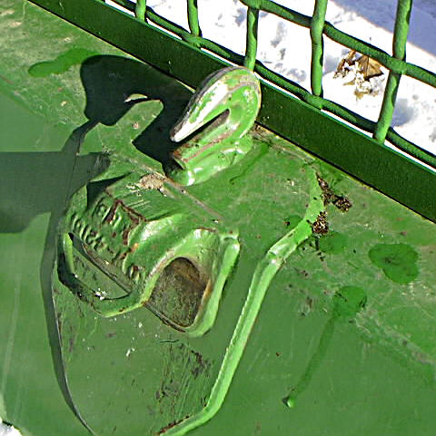

the dealer dropped my tractor off yesterday and spent about an hour going over stuff.the minute he left i pulled it into my garage and welded [2] 3/8 hooks about 1" in from the ends.i didnt use any reinforcment plates cause kubotas l7223 h.d. bucket looks pretty stout up top.it has a round tube running underneath the upper edge.the hooks would look better if i welded at the lift arm locations i think.but i did what the dealer told me.thanks for all your input.will be lifting some 12' railroad ties tonight.bws

<font color=blue>"I...welded [2] 3/8 hooks about 1" in from the (bucket) ends"</font color=blue>
For what it's worth, I put mine directly in line with my loader supports to minimize torquing the bucket or loader supports. Putting the hooks further out than that can result in some severe twisting.

i am going to relocate them in line with lift arms this weekend i think.today will be my first day testing out my new kubota were going to lift some rr ties for a retaining wall and move about 20 yrds of soil.took me 2 hours to get all the stickers/glue off that thing[think kubota tripple part marks everything]next tractor i will have the dealer do this.found a few loose bolts on the loader valve but everything else looks good.
