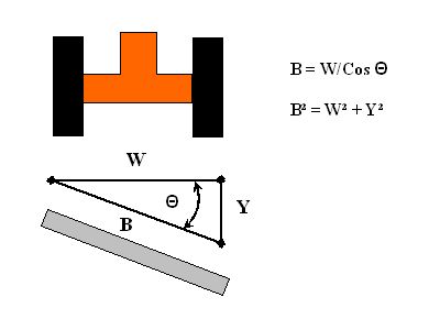

Pardon a "blue" guy from looking around in an "orange" thread, but I'm a nerd (engineer) by nature and can help with one part of this. I'm not familiar with a B3030 or its capabilities, but I can help you figure out how long the rear blade needs to be. Do you know either the angle you'd want to plow at or the offset (as mentioned by RussMan)? If you know either just plug this into a calculator: W = width of rear tires, B = length of blade needed, Y = offset OR theta = the angle you'd plow at
I did at least make the tractor orange here. :)

I'm an engineer by profession, although a 10th-grade trig student is just as qualified to do the math here... since I don't have one of those handy, I'll do it meself. :)
W = 54.5" (B3030 w/R4s)
B = 72" (6')
Max Theta = 40.8 degrees (just shy of 45 diagonal, which is too severe to be practical)
Max Y = 47"
However, the max angle on my RB72 is 30 degrees. At that setting, the effective blade width is 62.4", or about 4" extended past each tire (at 0" offset).
Like I said, 6' is big enough. My lane is about 750' so Leeds and I are in the same boat.
Looks good except that the blade pivots in the middle, so both ends of the blade move to a narrower position.
