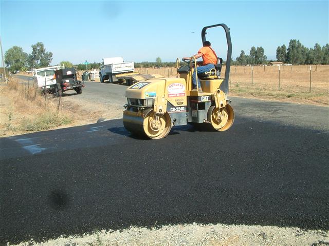

Looking to get a used roller to help maintain our long gravel driveway (1/2 mile) and parking lots at work for our semi-trucks.
What size should I be looking at? I found a Ingersoll-Rand DD22 about an hour from me, in my price range with low hours on it. It's a 2-4 ton machine with vibration. Plus, still easily transportable at a 3 ton weight.
Is this enough, or should I be looking bigger?
Here's the roller my contractor used to install my gravel driveway (20 ft W x 330 ft L, 6" thick crusher run, three 2" lifts, water and roll each lift) and the asphalt paving to connect it to the county road.
Good luck
