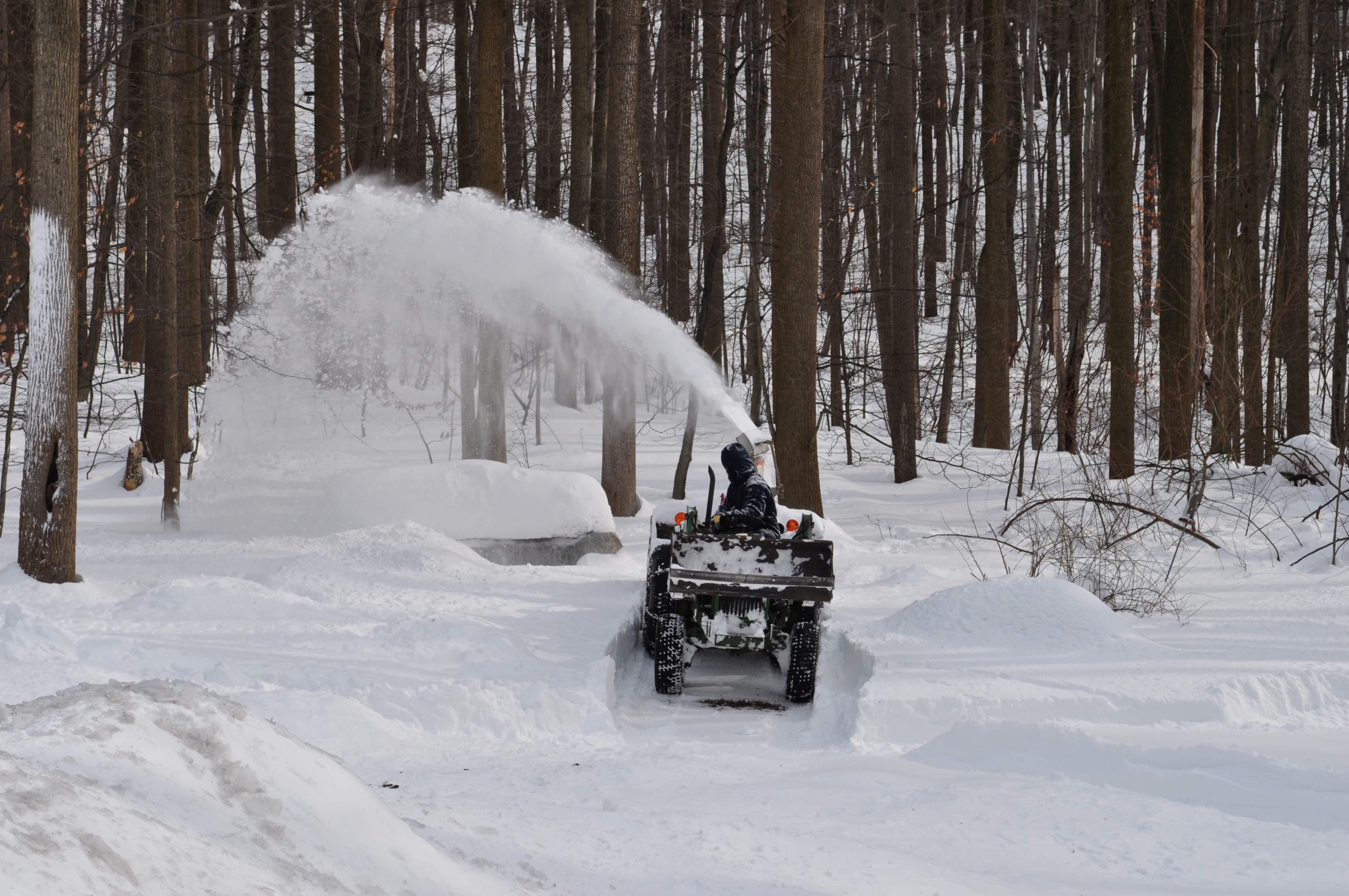

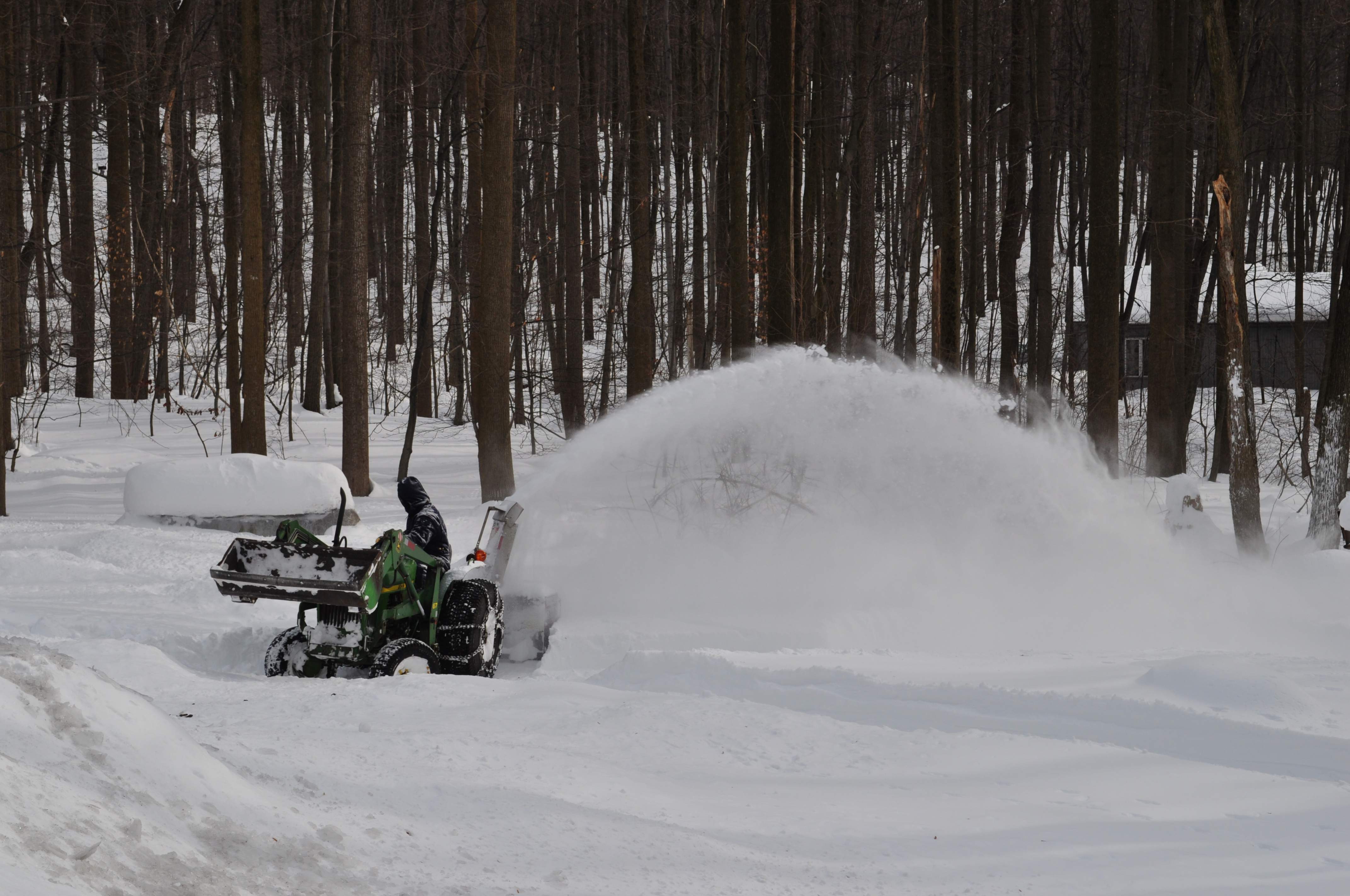

I had a JD 750 with 60" rear blower that served me well for many years. The PTO HP on this tractor is 18 versus 19 for the 855. With the 855 hydrostatic drive you'll be better off than with manual I had. Deep snow wasn't a problem!
Just make certain it is wider than your rear tires.
