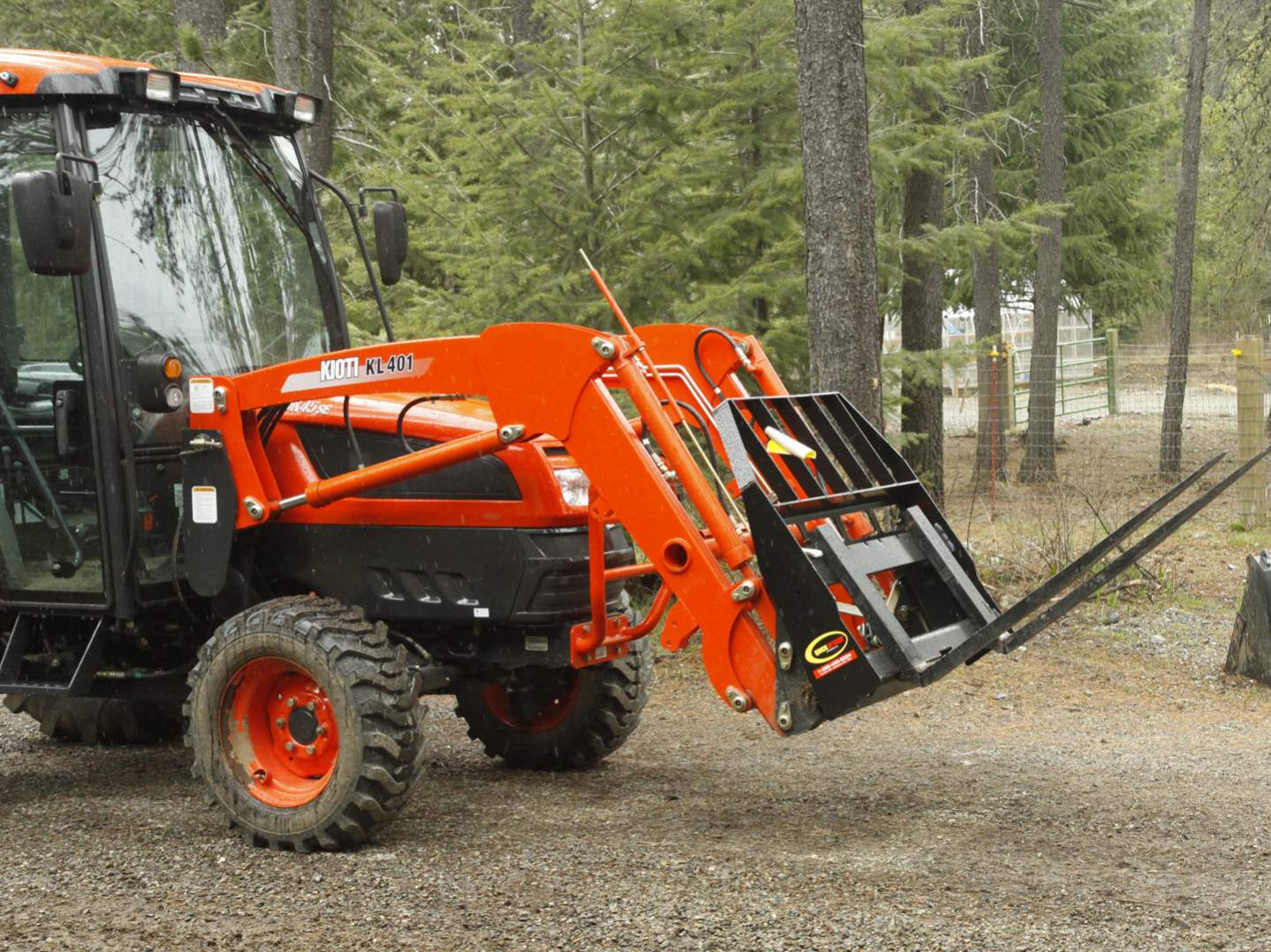

My DK45 cab HST has unloaded several things from semis already. not an issue. Mine has a lifting capacity of about 2,700#. Remember if you want to lift 1500 allow another 400-500 for the fork attachment. I personally wouldnt lift 1500# with a set of bolt on forks anyways.
i simply love the factory cab...especially with winter work.
Also consider filling the rears with rimguard or other product. Mine added about 900# of rear end ballast doing so. Lifting heavy loader weights benifit from filled rear tires
