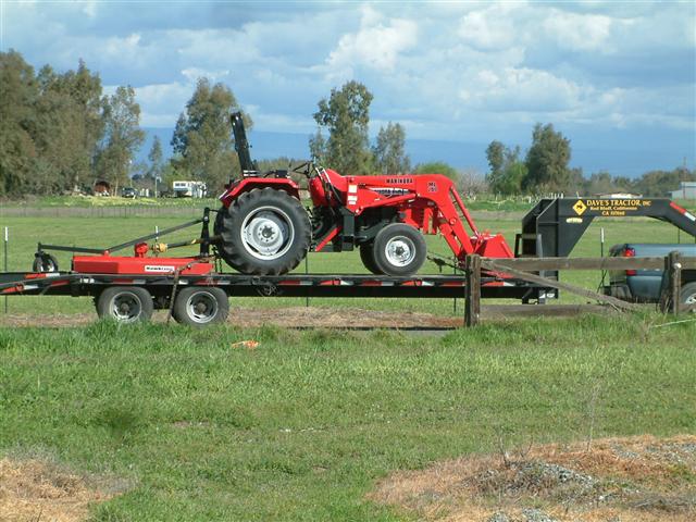

A CUT with 35-50 hp (pto) will handle your chores nicely. I grow hay on 6 acres using a 2008 Mahindra 5525 (54 hp engine, 45 hp pto, 2WD, gear tranny 8F/2R, power steering, triple rear remote hydraulics) with the ML250 FEL (6-ft wide bucket, 2950 lb lift to 10.5 ft height, 3 chain hooks, skid steer quick attach brackets on the FEL arms). Cost: about $19K new.
My brush hog is a 6-ft Hawkline ($1150, bought as part of the tractor package).

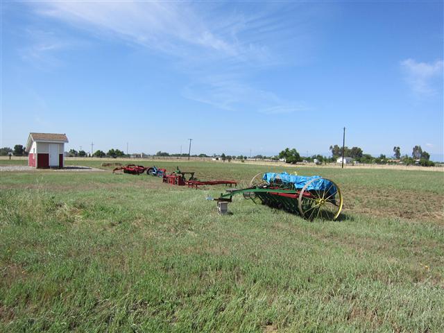

I run used haying equipment--10 ft wide grain drill (refurbished Minneapolis Moline P3-6), 6.5 ft offset disc, JD350 side delivery hay rake, MF31 sicklebar mower (7 ft), MF124 baler (2 twine, small bales).
