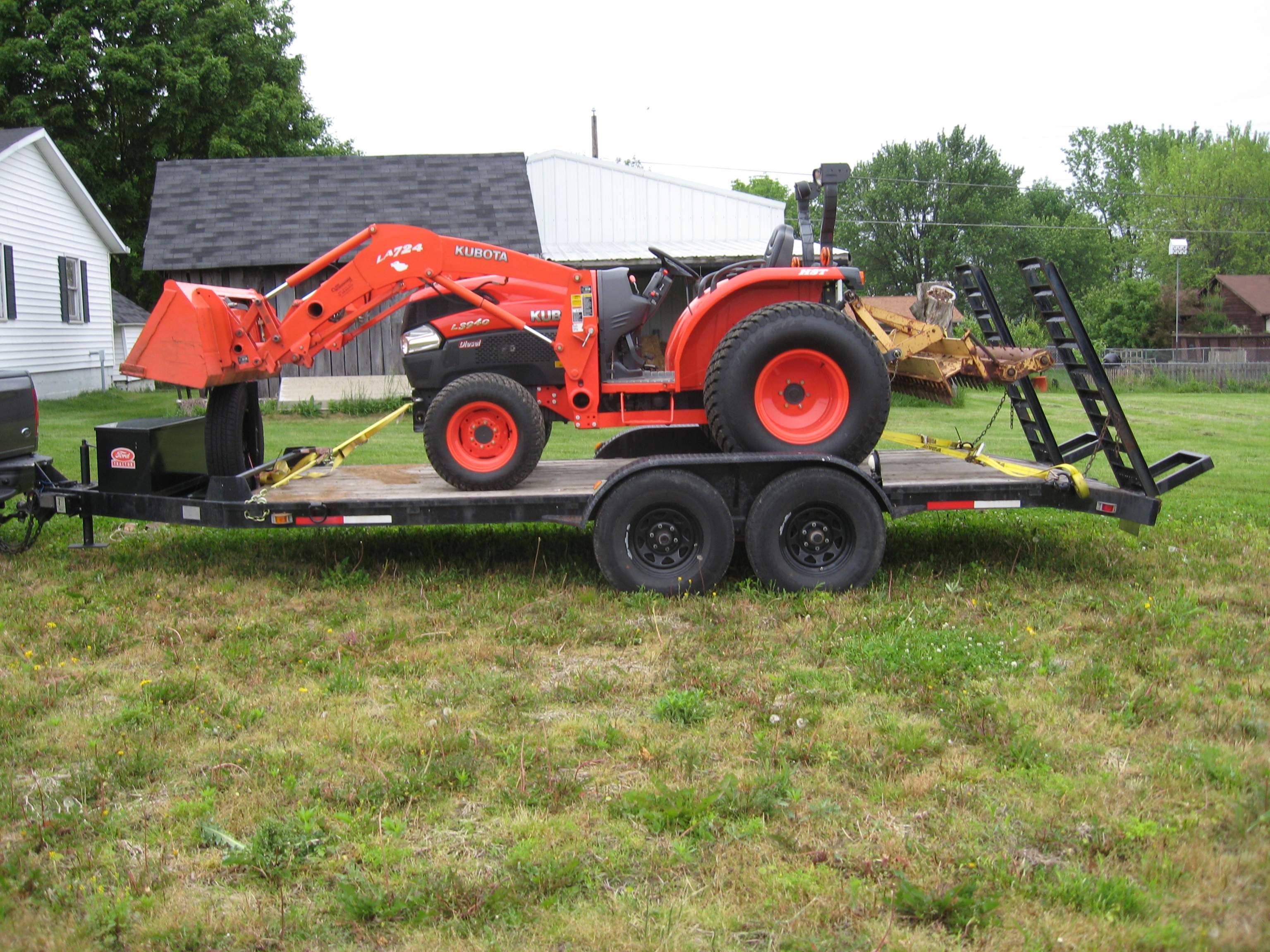

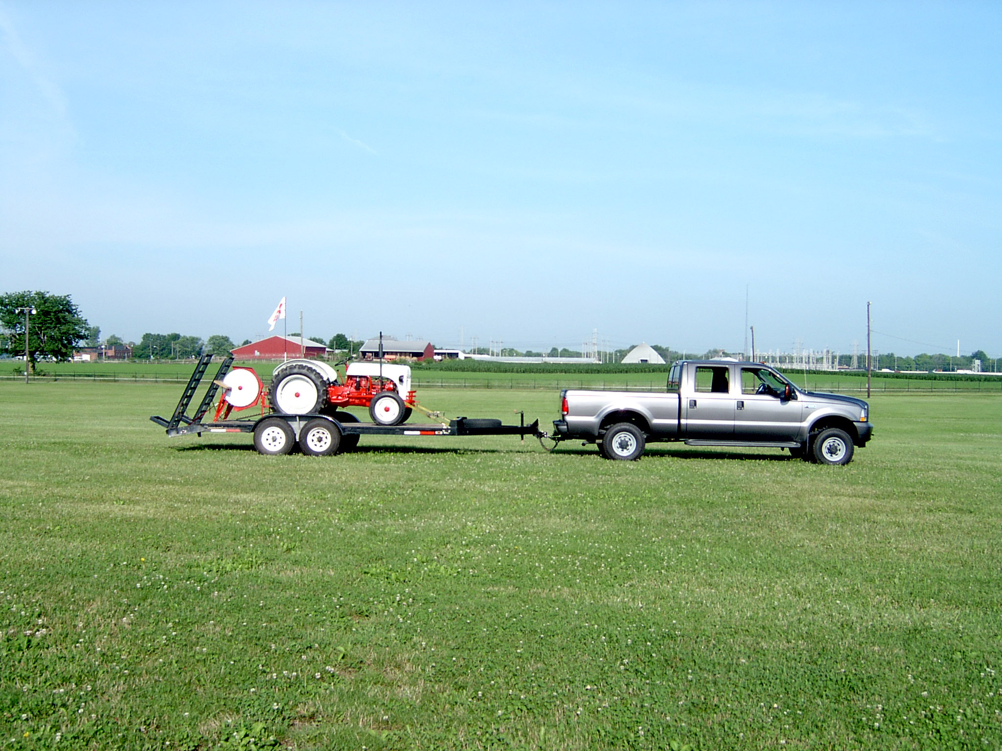

I use a 16' + 2' beaver tail rated 10K for my L3940 and 8N. Bought it off work, it was a good deal. If I had to do it over again I would look hard at the 18' + 2'. Weight adds up fast, a 4000# tractor + 1000# FEL + 800# implement + 2700# trailer = 8500#'s. Keep that in mind. Learn what GVWR (for truck and trailer) and GCVWR means and go to the scales. Stuff adds up fast, especially tounge weight. Philip.
