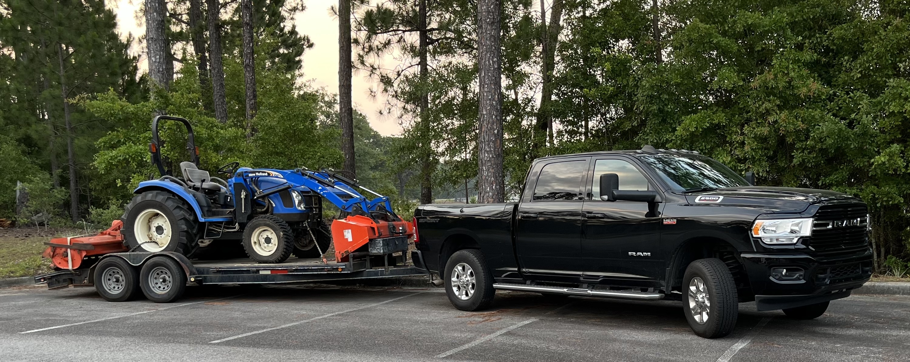

Hey there folks,

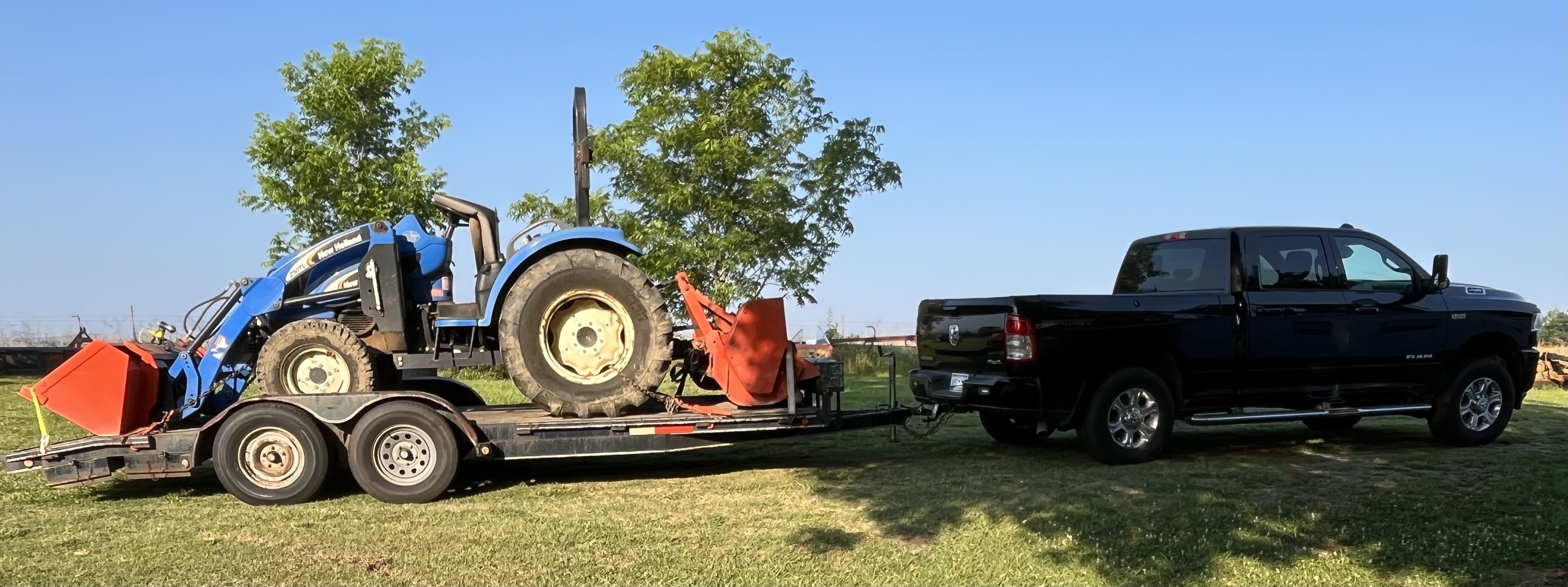

My father-in-law is considering* letting me borrow his Deere 4520 TLB to save money in lieu of renting a mini excavator. The trailer at the local rental place was large enough for my CK2610, but the 4520 is considerably larger- and has a backhoe, so I couldn't begin to know if it's large enough. What size trailer ought I be looking for? I just want to be ready if this goes into motion.

A car hauler with double axel will work for width (72 inch wide tractor) with a tandem with 3500lbs axel it will be closely legal with a GVWR: ~7,000lbs.... the 4520 weigh around 3800lbs plus the FEL plus the backhoe, you are likely looking at 7000lbs if he has filled read tires... So if you want to play it safe go with a tandem with 5000lbs axel or a GVWR 10,000 lb trailer. But personally I wouldn't be scared to go with the 7000lbs.

Would not go with anything less than 10k gross trailer, so dual 5k axles. probably need 18-20 ft trailer to move tractor around to get load situated
