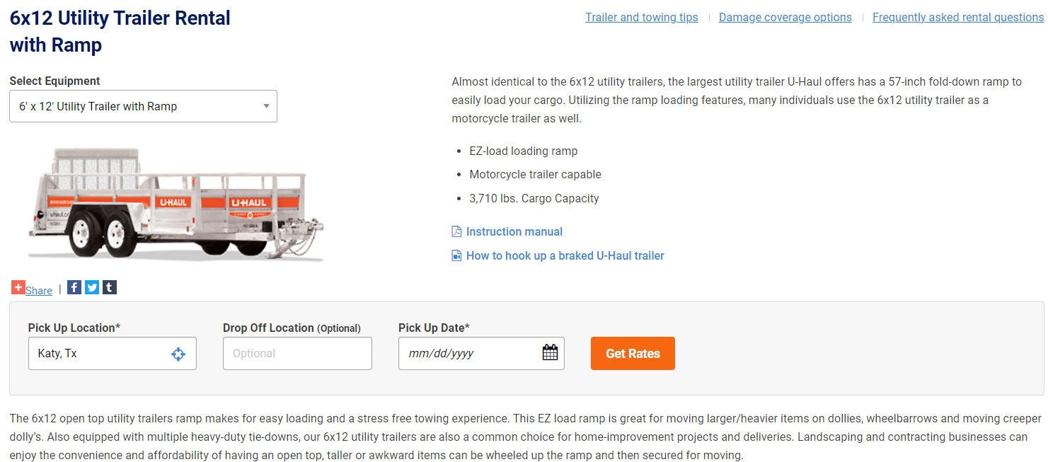

The Kubota BX2680 weighs around 1500 lbs (plus the FEL). THe Uhaul trailer has 3500 lb load capacity, so it seems ok. I won't have any rear attachment just the 3 point hitch. The length of the tractor is 8 ft. I'll have to check if the tractor plus FEL is less than 12 ft in length.
Thanks for all the advice.

From the looks of things you'd be way-good with that U-Haul w/o removing the FEL. I suggest backing onto it and in 4WD for weight distribution and ease of loading/unloading .. and for towing without 'wagging the trailer'.
