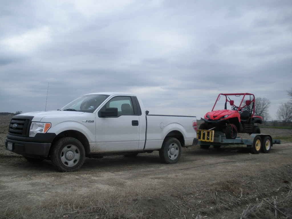

I pulleda 16 foot dual axle, no brakes, this last weekend picking up up the Teryx I just bought. That worked great but the Teryx only weighs 1300 pounds or so.
