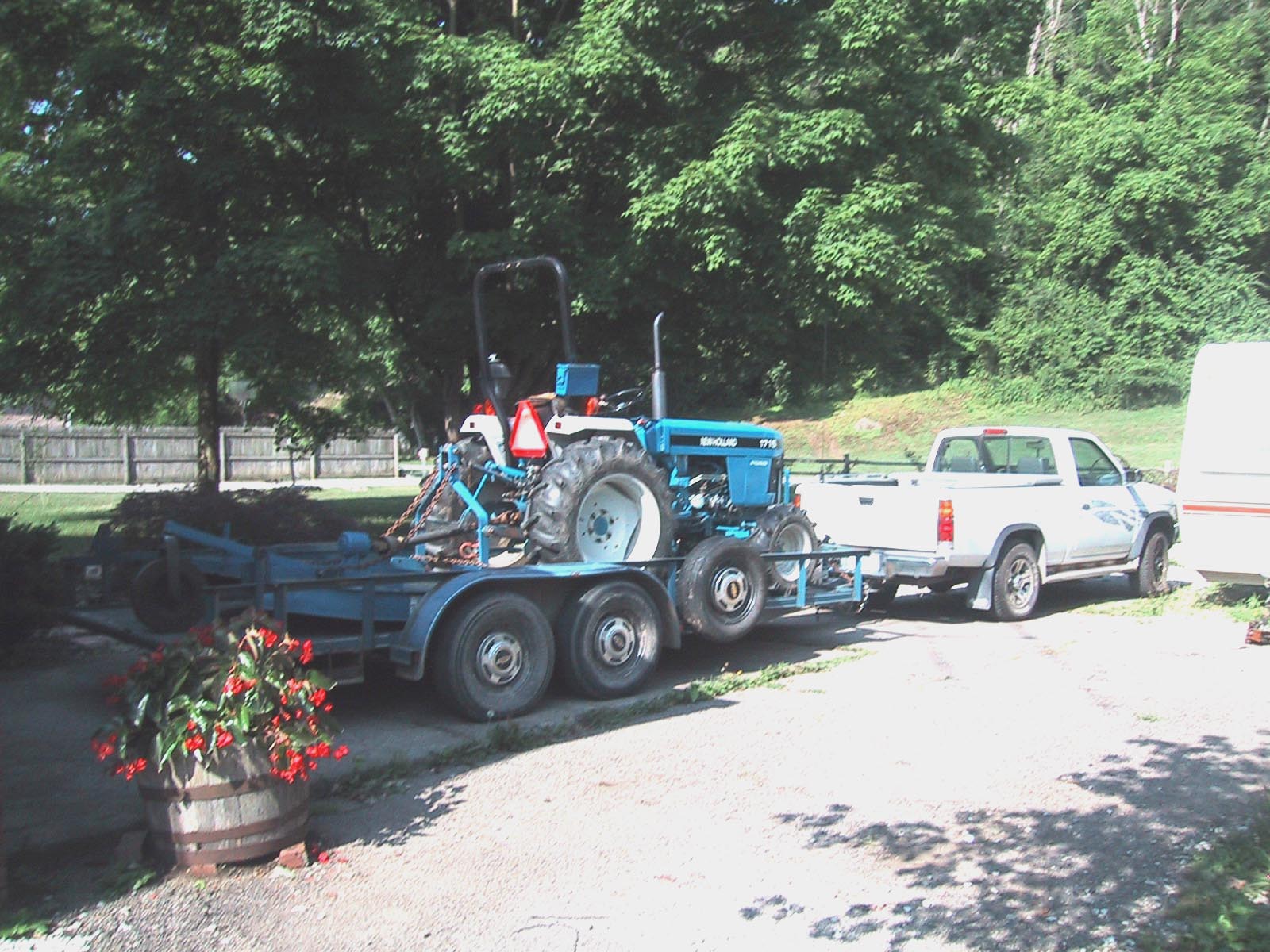

I pull a 1715 N/H on a 16' Utility trailer with a nisson Hard body with a 2.4 4 cyl , 5 speed trans , 4.10 rear. but the truck is rated at 3/4 ton. Weight of trailer is 1300 LBS , Tractor 3000 With tires loaded and Brush hog attached. that is 4300 LBS . 800 LBS over rating of truck. use equlizer hitch & sway control. have brakes on all 4 wheels of trailer, and that is all the truck wants belive you me. Will pull but you have to keep a fire lit under it .I have pulled tractor for 4 years with this truck tuffest little truck I have ever owned.
