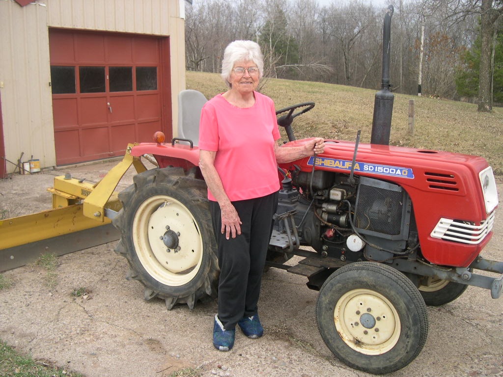

I've had 15hp, a 24hp, a 33hp and 40hp tractors. I like the 40hp the best, but I liked em all. I think 40hp is the sweet spot for your property, but if that's not in your budget, a 30-35hp tractor is pretty sweet. I ran a 5' rough cut mower with my 24hp tractor with no problem.
I cut trails through 8' brush with my little 15hp, and with no advance clearing. I just walked it first, and then plunged right through it!
