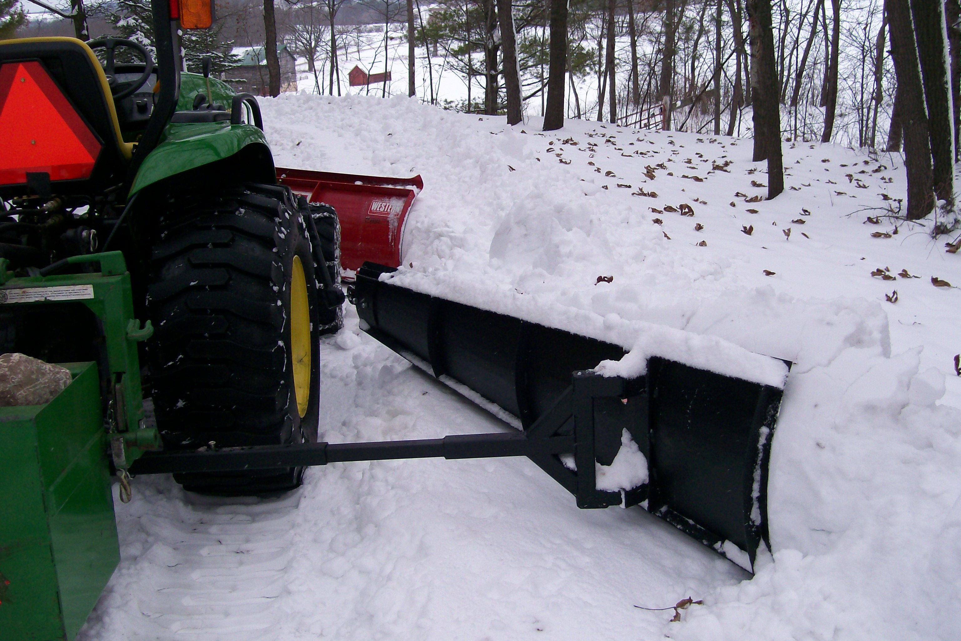

For widening, just add a wing plow when needed (which isn't often) and knock the snow berm back a ways.
