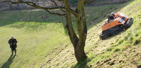

Increasingly robotic flailmowers are being used for dangerous high angled slopes and banks where rubber tired tractors are unable to maintain traction and the angle of attack is too great for mowing vehicle ascent unless winch is used as in the case of the "Spyder" brand of robotic rotary mowers which employ three rotary mower blades, and a belt and mechanical for wheel drive system. The winch for the spyder mower is an optional item for Spyder mower
I have enclosed two images of a Simon Tullet Roboflail tracked flailmower for your use.
