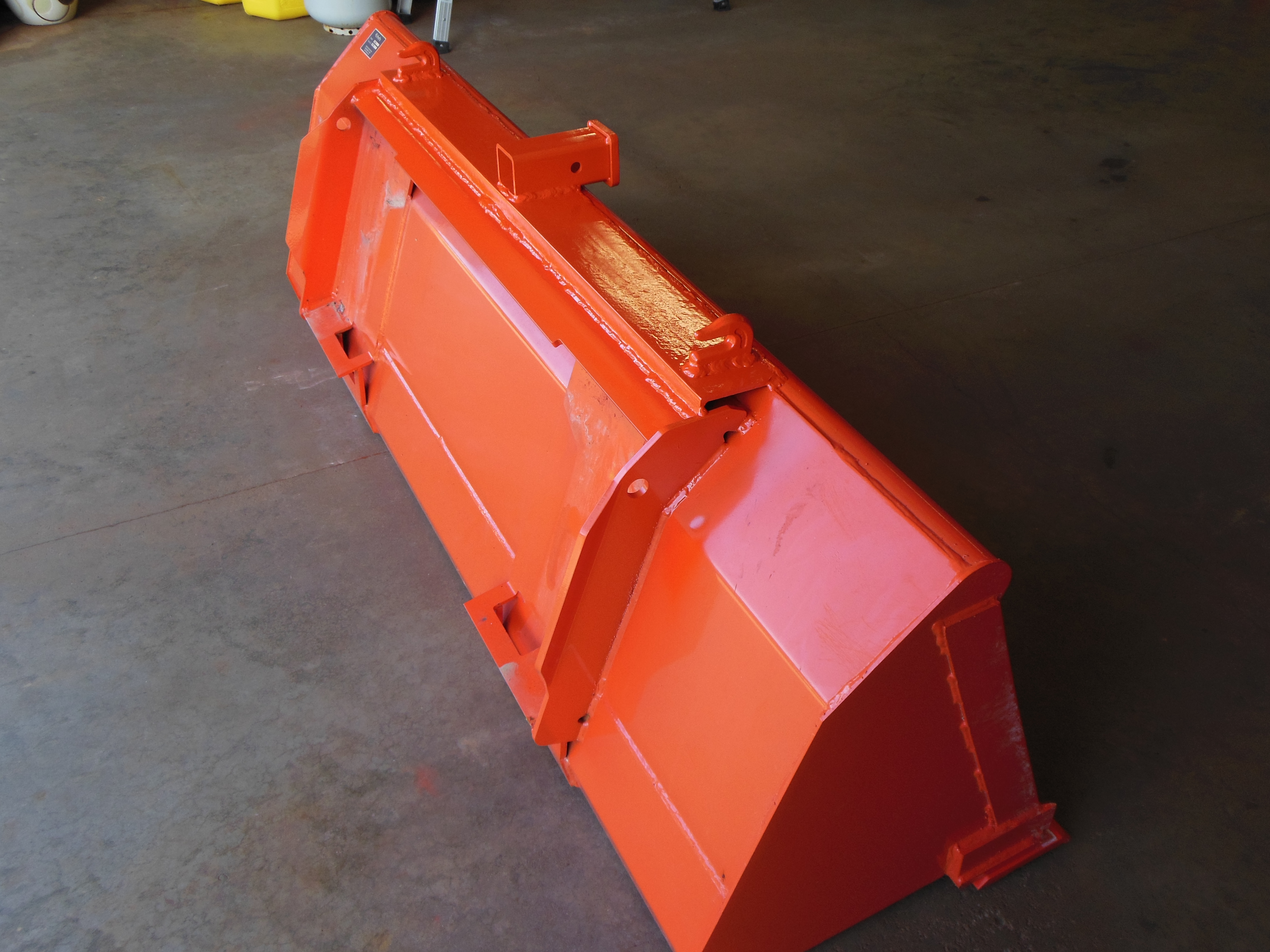

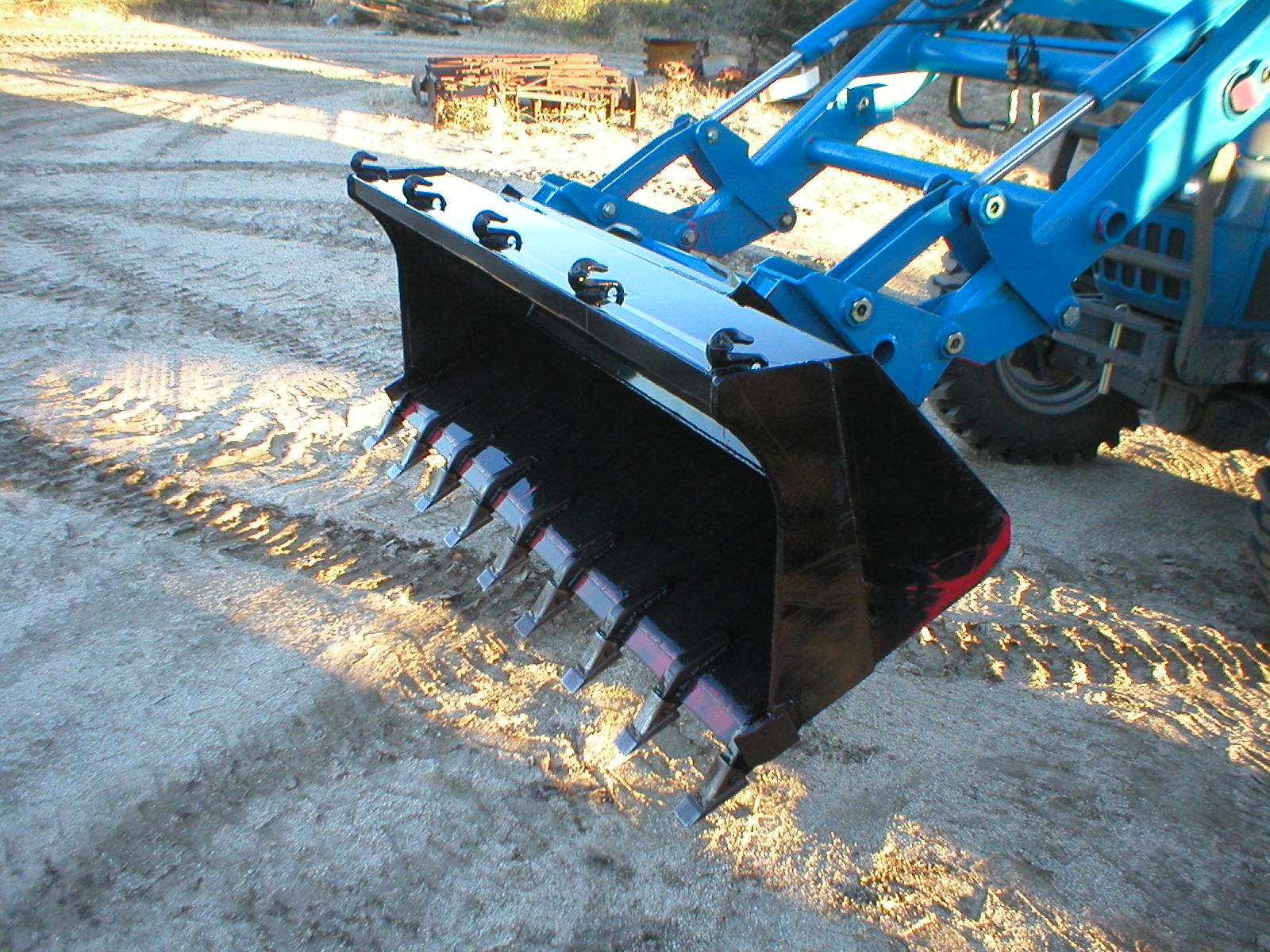

   / What thickness angle iron to weld hooks on bucket? #18
Brian, difficult to see detail on your bucket teeth.
Are they custom, individually welded on, bolted on - or is it a commercial tooth bar add on?
Interested...
It is a 78" bucket with individual welded on mounts and pinned teeth. I have an 84" bucket with smooth cutting lip for moving loose material.
   / What thickness angle iron to weld hooks on bucket? #19
Thanks for that...it looks strong!
