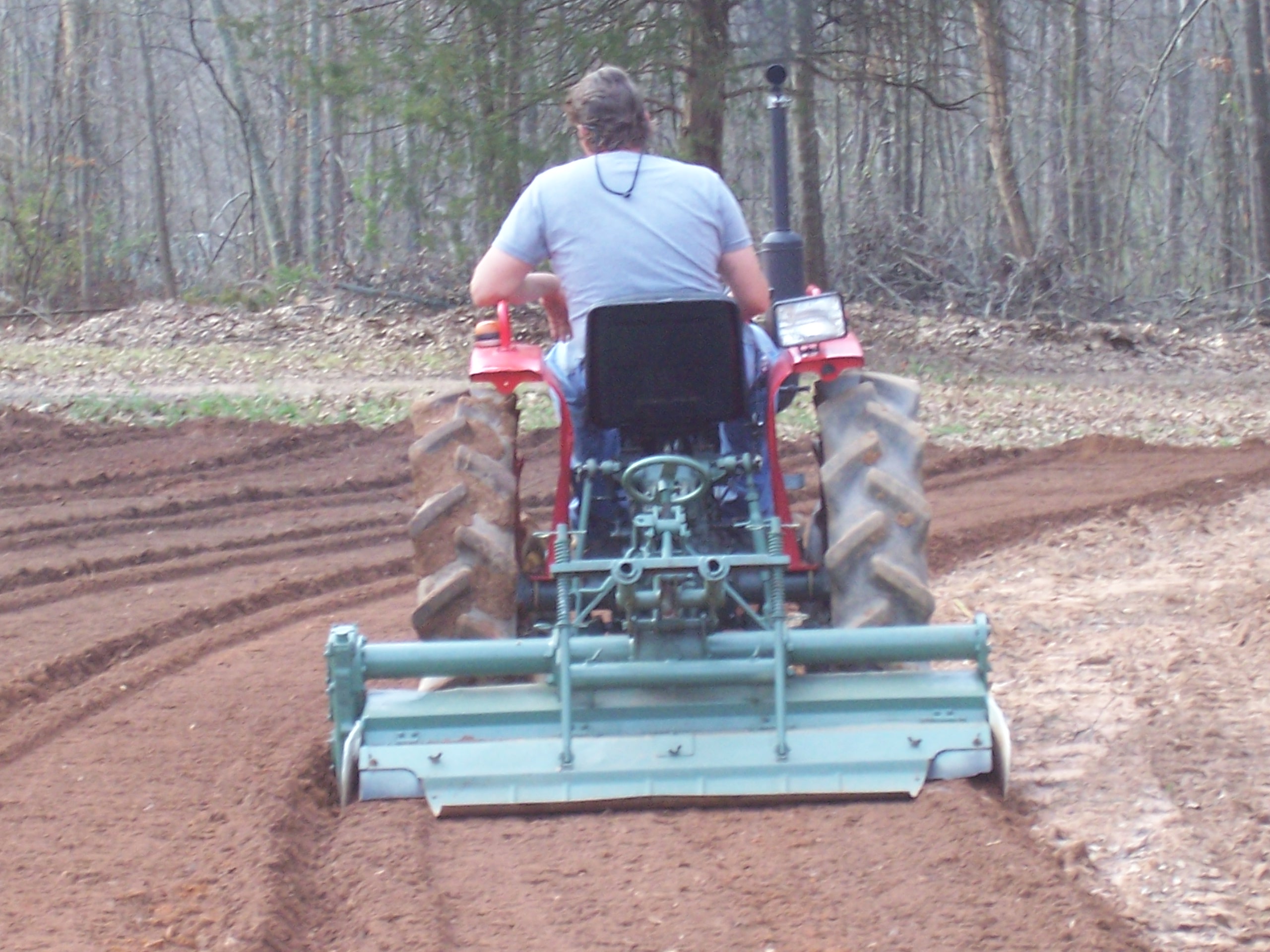

In Ga. You won't need them. Here's my ym2000 and the RS1400. It worked great just for a small garden. Well worth that asking price. Looks to be in as good of shape as mine was. Better condition if you feel the need for the wheels. My wheel mounts were missing and was told it wouldn't be a issue. It came from Fredricks as is and was told the same thing as Cal. that it came factory with it. Add the cost of new tines and your still be under what I gave for it over 3yrs ago. You will need the Top Mount you can make one fairly easy if need be. Oh and the reason I have the extra Dr. shaft They gave me the wrong one and you will see were I made some changes. I'll let it go cheap If you need it.
