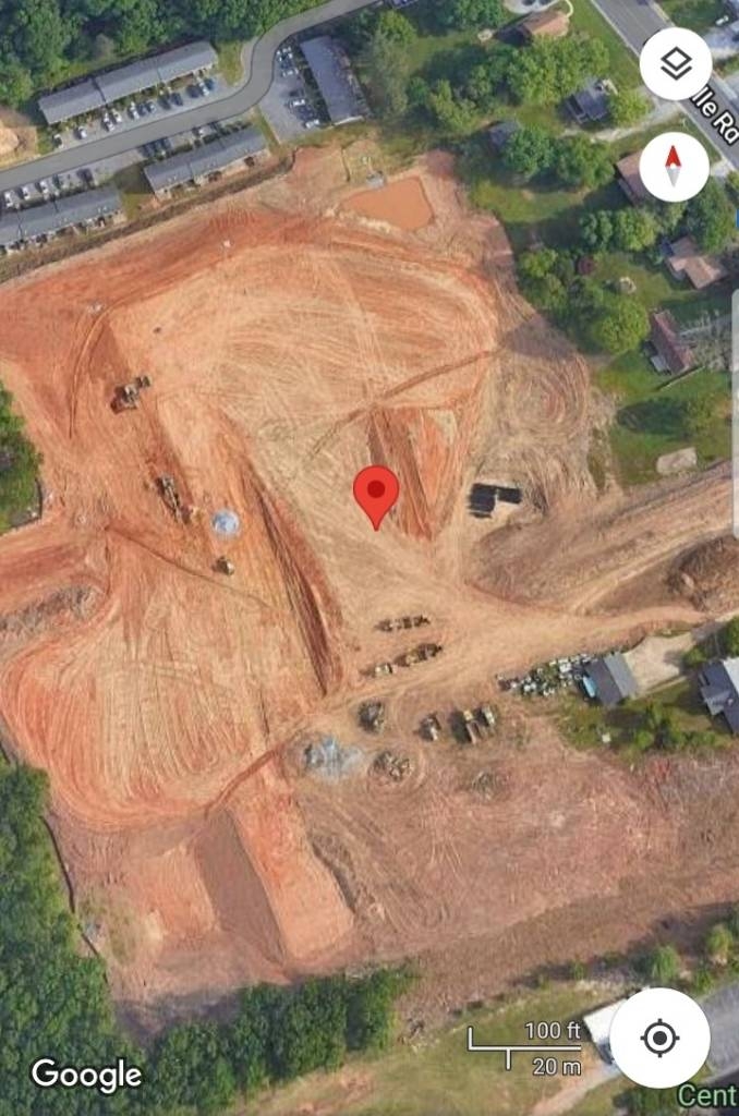

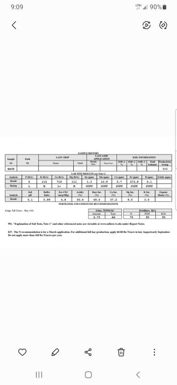

I had soil tested I bought as 16 tons topsoil which I spread in front yard depressions, it rained that night and it turned to like concrete. It came from where an apartment complex is going in, the delivery place refunded my money. I couldn't believe how acidic it was, 5.1ph, and why it would be.
I'll till areas, add fertilizer & lime I assume then add real composted topsoil and plant fescue late summer.
Thoughts are appreciated and I'd like to buy a good ph meter. I have two but they weren't accurate.

Nothing beats scraped off clay for concrete... Your county extension agent should do a soil test for you, usually free.

That's what baffles me...someone told me they thought it was crushed cinder block, concrete or limestone but that has a ph 11. This is 5.1!
I put some in large containers for wife to plant vegetables, after getting report I put a handful of lime on plants then watered...overnight they bloomed!
