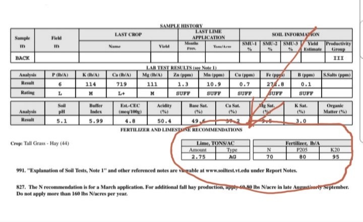

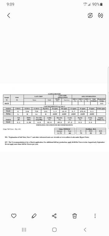

I had soil tested I bought as 16 tons topsoil which I spread in front yard depressions, it rained that night and it turned to like concrete. It came from where an apartment complex is going in, the delivery place refunded my money. I couldn't believe how acidic it was, 5.1ph, and why it would be.
I'll till areas, add fertilizer & lime I assume then add real composted topsoil and plant fescue late summer.
Thoughts are appreciated and I'd like to buy a good ph meter. I have two but they weren't accurate.
Thanks.View attachment 803794View attachment 803795

The county agent called and suggested 10-10-10 since numbers were close as well as lime to raise 5.1ph to normal, 6.5-7.
Half now, till it, other half in 1-2 months and then I'll put real topsoil on top, seed tall fescue in September.
It should be fine.

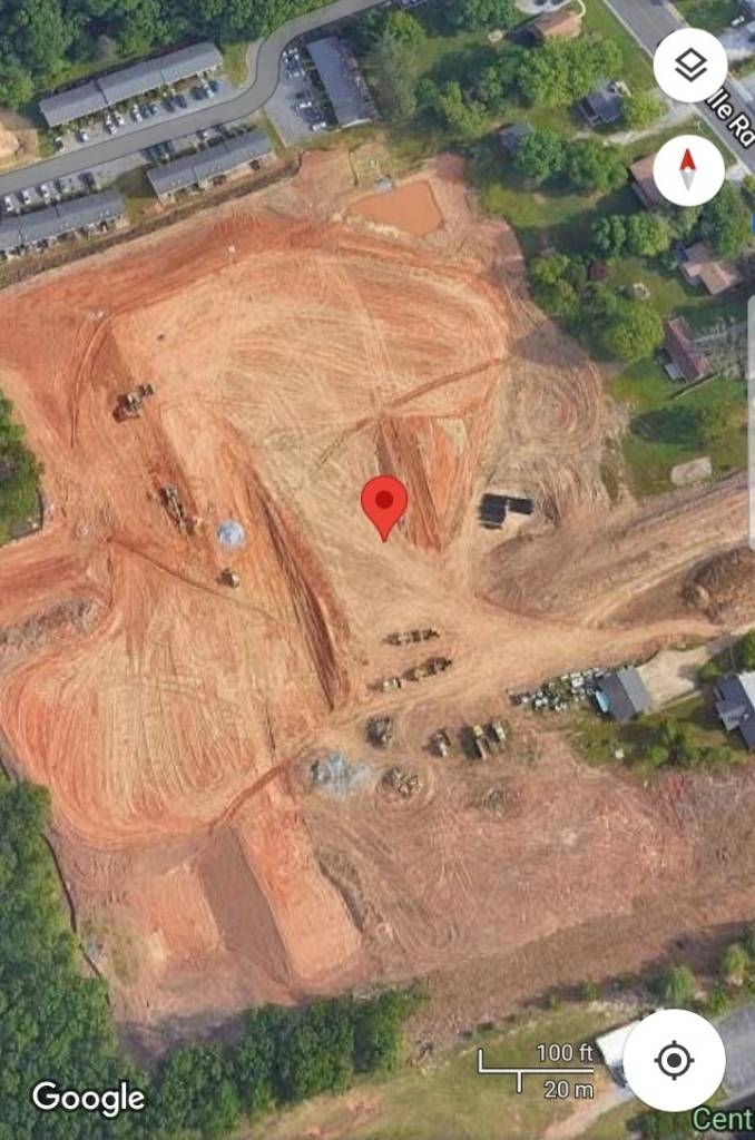

I found a satellite view of that area before any digging and it showed 28 acres of scrub pine and unkept land. Everything I know now it wasn't a landfill or dump site, there was (is) some small amount of broken glass in it. Lots of rocks walnut sized.
I'm sure I could sue the guy, have all that removed but what a mess that would make.
The county agent said after fertilized, tilled, good real topsoil on top it will be fine.

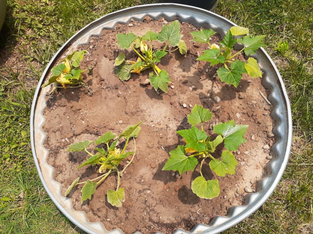

I filled large containers with this junk soil for wife plant vegetables. I should have taken before pictures...plants barely living. This is after sprinkling lime and they improved overnight. I just now got ph litmus paper test kit, see what it is. It will never do well (my opinion) because I'd have to remove plants, remove soil, add lime, fertilizer and organic compost (we have horses), mix and replant.
Essentially that's what I'm doing on the land.
