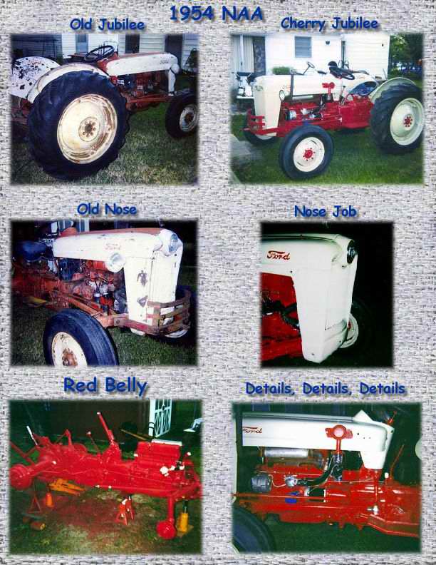

Chris did a great job on his Jubilee, but I can't let him get away with showing his restoration without showing mine too. /forums/images/graemlins/smile.gif The attachment shows some highlights.
My NAA is out of service and badly in need of some TLC. I worked it hard for almost 10 years with very few major problems. Then, it seemed like several things broke at the same time shortly after I bought my NH TC45D. I just haven't had the motivation to fix the NAA. It may show up for sale on ebay or TBN soon. It has brand spanking new tires and wheels with the front wheels filled with foam. If I sell it, I'll try to get my tire and wheel money at least. We'll see... /forums/images/graemlins/smirk.gif

Nice nose job. i had to do a nose job on mine as well. Had a bit of rust holes here and there, and had to rebuild a few contours.
Great job.
Soundguy
